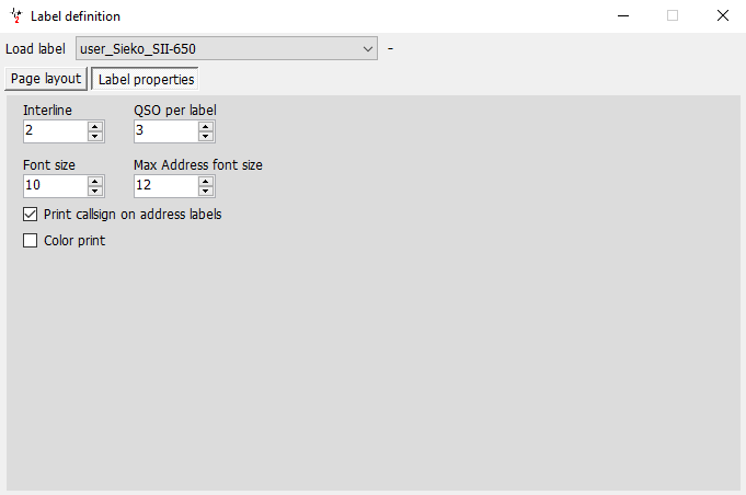

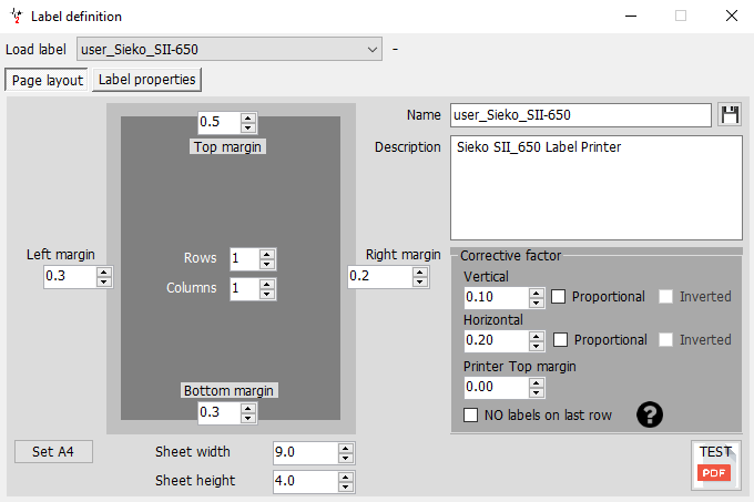

If anyone is trying to use a Sieko SII-650 Label Printer here are the settings.
Ken, AC5EZ
Sieko-SII_650 Label Printer-01.png (22.68 KiB) Viewed 1601 times
Sieko-SII_650 Label Printer-02.png (8.77 KiB) Viewed 1601 times
