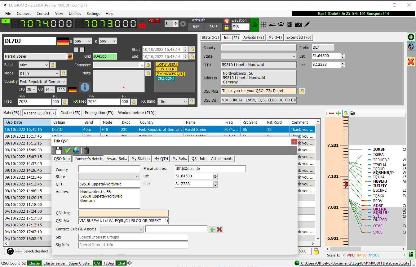

I've just done another test on FT8 and can reproduce the original problem. ie that QSOs logged via WSJT-x do not populate the QSLMSG field in Log4OM, see below;
Screenshot 2022-10-10 174335.png (157.52 KiB) Viewed 732 times
I assume that if WSJT-x is using an ADIF file to transfer data to Log4OM could it be overwriting the QSLMSG with a blank record? Struggling to figure out why it works from Log4OM and not from WSJT-x. :?

No! If there is no QSLMSG provided by the FT8 program it is saved and uploaded as is.
Remember the FT8 program is saving direct to the sqlite database
Get WSJT to add a QSLMSG

Ok, so if WSJT-x does not provide a QSLMSG, then Log4OM will not put in the default message either?
So this bypasses the QSO front end, and therefore bypasses the code that adds the default QSL text?
I'll take another look at WSJT-x, but not seeing any easy way to add more fields to the QSO, so will log another call with them as well.

You could edit the QSO's after they are received from WSJT by adding the QSLMSG then do a manual upload instead of automatic
That said with the automatic nature of an FT8 QSO is the QSLMSG relevant or even noticed by the other party who probably receives hundreds of worked stations on FT8 by his robot software.
