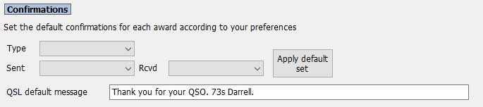

Maybe doing something wrong, but I am not seeing the comments fields in QSL Comments fields logging on the eQSL.cc site?
I have added comments to the following screens in various tests, but not sure which one should work.
Started with the settings;
Screenshot 1 - Settings.png (8.36 KiB) Viewed 1379 times

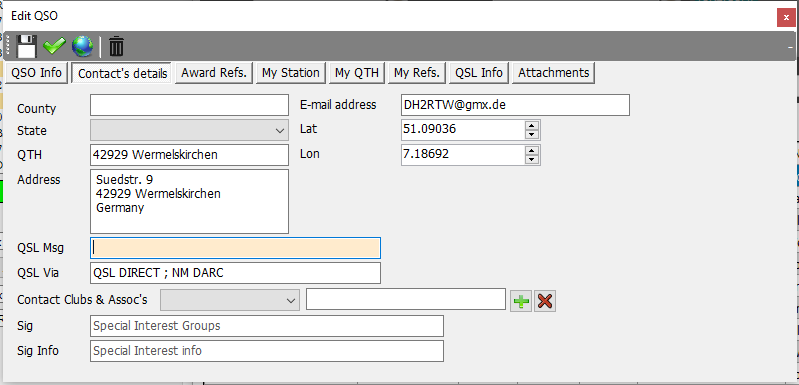

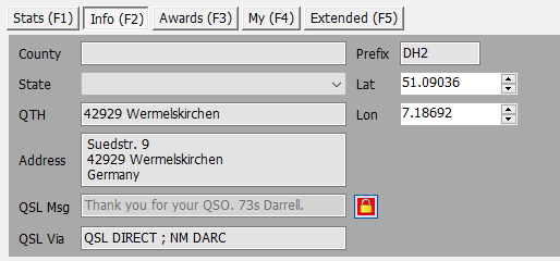

That didn't work, so I added to the F2 tab and tried with and without padlock ticked;
Screenshot 2 - F2 screen.png (15.8 KiB) Viewed 1379 times

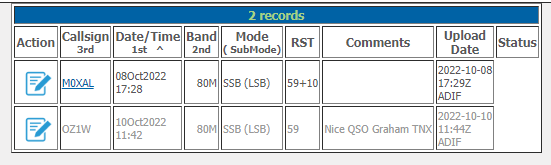

But still don't see the text coming through on QSOs;
Screenshot 3 - Example QSO.png (29.57 KiB) Viewed 1379 times
Am I missing anywhere else?

Just for the avoidance of doubt. Am I correct in assuming that the text in the "Confirmations Settings" is what gets populated in the interface?
Thanks.

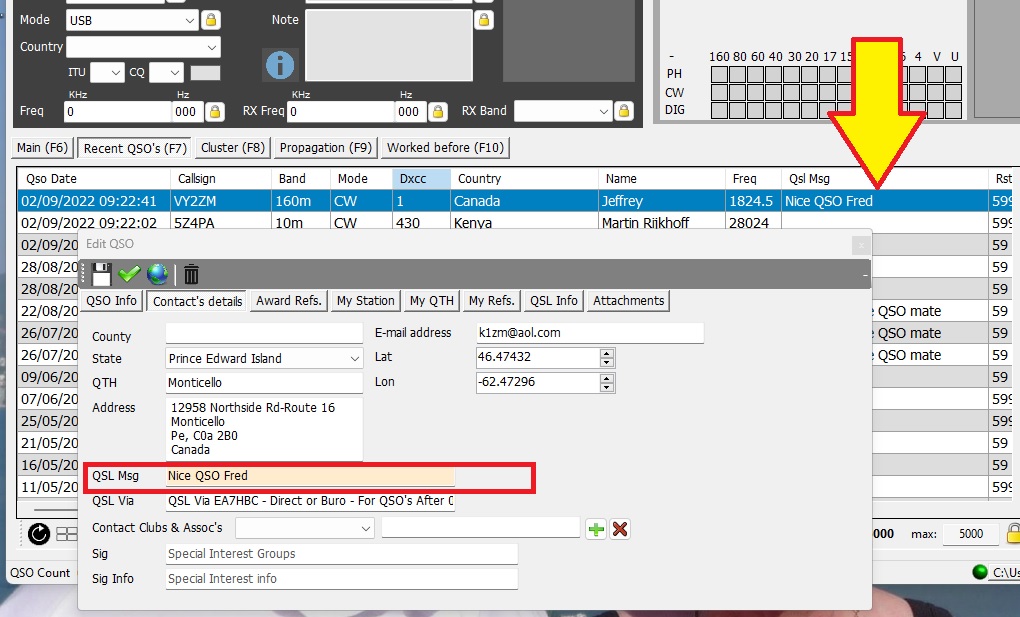

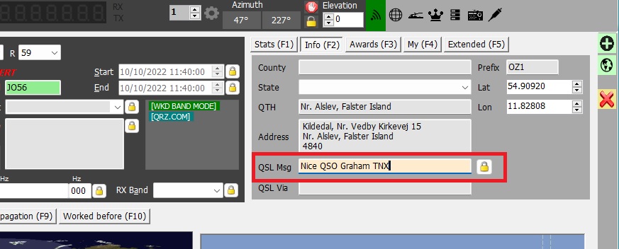

Re: eQSL not populating comments?
FAQ :
The ADIF tag COMMENT is used for private comments about the QSO. We found out a decade ago that people did NOT want those comments disclosed on their cards! The ADIF tag QSLMSG is designed to be used for QSL Card Comments. That is the one we display on the eQSL card.
73 - F6DKQ"

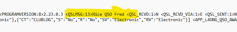

Partly right! Comments is the comment that is public and NOTES are the private comments like 'this guy's a nutter'
However, see image below
And we export it in the ADIF export file as below
Screenshot 2022-10-10 123715.png (8.79 KiB) Viewed 1351 times

m0odh
Posts: 11
Joined: 05 Oct 2022, 12:47
Post by m0odh »
Thanks Terry for walking me through this.
I'd populated all these fields, so not sure why it was not working. Just went through and set everything up again and tracked it through the process and it works if I add a QSO manually. So I'll do some more testing later using WSJT-X and FT8 and see if it works there.
Right now though I can see the QSLMSG field is now appearing in the log;
"QSLMSG%3a36%3eThank+you+for+your+QSO.+73s+Darrell."
And the QSL Text is going through the interface to eQSL.cc;
Example QSO Card - Screenshot 2022-10-10 151629.jpg (59.22 KiB) Viewed 1342 times
Thank you for your patience. ;)
