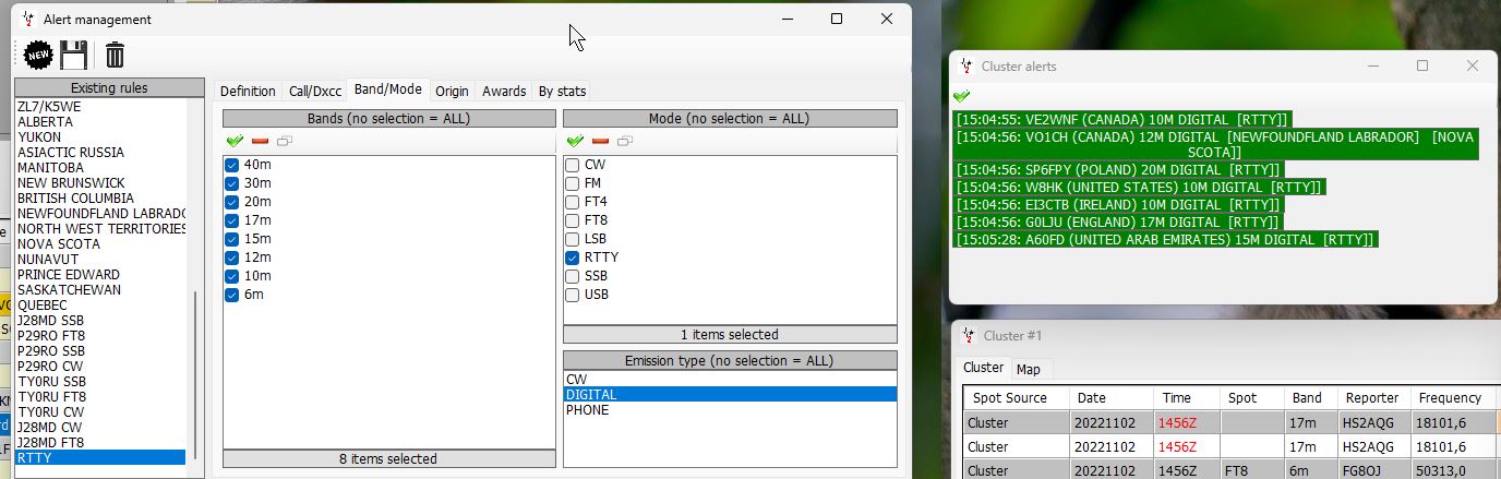

I would like to get an alert only if mode = RTTY whatever the call
I did that but apparently it didn't work...

Unfortunately the CLUSTER protocol doesn't provide any information about the MODE used by the operator.
In some cases Log4OM is able to detect the mode from the NOTES added to the SPOT by the reporter (or based on specific frequencies on bandplan)
The "MODE FILTER" works on those (few) well identified spots (works better on SUPERCLUSTER data that are providing MODE too)
I've identified a small glitch on the alert routine that may create some false positive reports and will be fixed in the next beta.
For generic use, please note that MODE filtering is very selective as very few spots can be identified exactly on a specific MODE.
Thanks for reporting

OK Daniele Thanks ...
