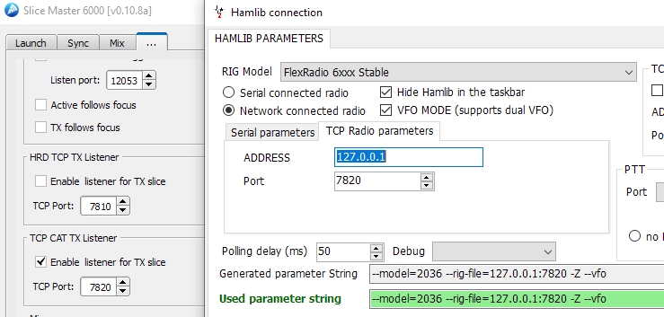

I am using a Flex 6600 with SliceMaster and connecting via Hamlib was working flawlessly through version 2.24.
I just upgraded to version 2.25 and now have a connection issue that rebooting/restarting the programs doesn't solve. The CAT/Hamlib settings were carried over from 2.24 as expected and the connection icons all are green, but in reality the radio is not communicating with Log4OM and the freqency display shows "OFFLINE". None of the settings changed during the upgrade, and when I downgraded back to 2.24 it connects immediately.
Here are my settings that are working with version 2.24 but not 2.25.
