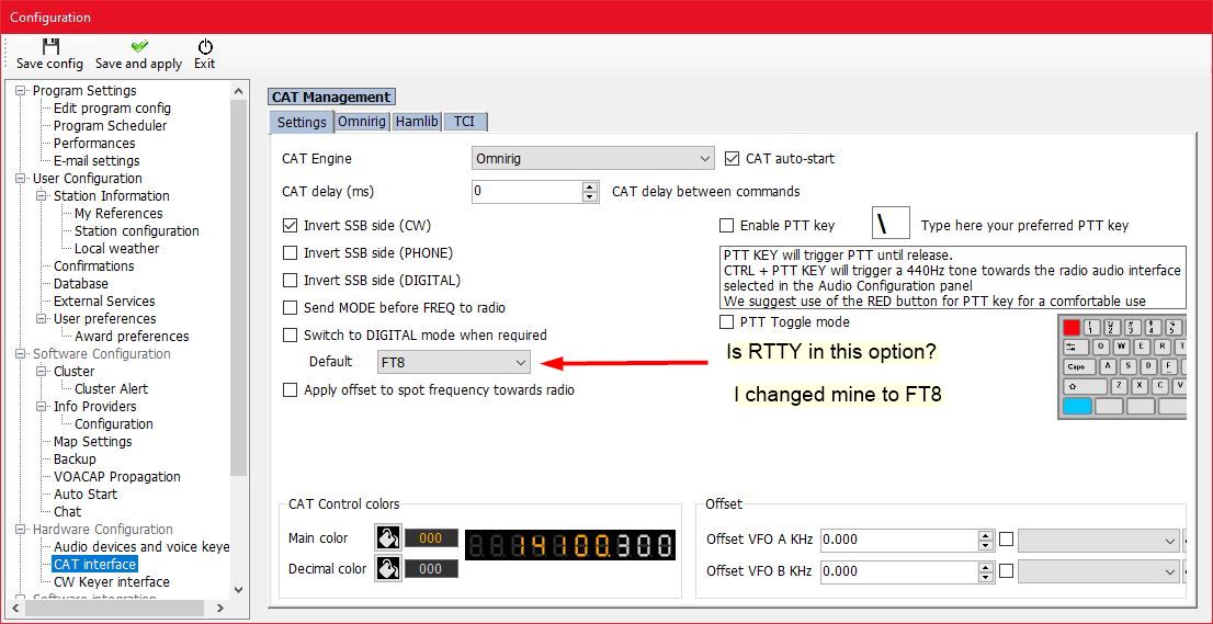

Check your CAT configuration and see if you have RTTY selected there. If so change it something else and the RTTY should then disappear.
I've experienced the same as you have noted and decided to choose FT8 for this option.
Note image below.
- catmngt.JPG (108.69 KiB) Viewed 1498 times

Re: Mode selection In user preference
Jan,
Even though you noted that you don't use CAT ... did you try (as a test) to change whatever value appears in the default box that I noted in my image that I included in my above post?
Change it to another choice, save and then restart Log4OM and see if changing that value puts something else in the mode box other than RTTY.
It can't hurt to test and see if it changes ... or maybe it won't change. But, at least you will know.
