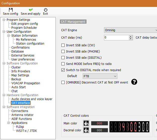

I did not understand how the CAT works when we select "Switch to DIGITAL mode when required"
I validated this option by selecting the FT8 mode by default
but in the input interface the mode always remains in USB (I am in USB to do FT8 with my TX (FTdx5000) )
I can change bands and position myself each time on the FT8 frequency in each band, the mode always remains USB
Settings CAT Log4OM2020-11-22 164951.png (46.43 KiB) Viewed 2933 times
So when does the mode switch to "DIGITAL" ?

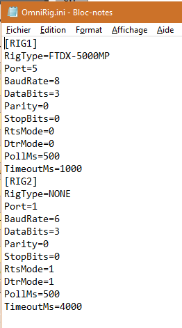

Perhaps but where exactly ?
I use JTDX and Omnirig
On Omnirig I don't see anything abnormal :
Omnirig Settings 2020-11-22 173647.png (14.85 KiB) Viewed 2928 times
and on JTDX Settings I don't know where and what to look for :-)

Re: CAT Interface need help ...
No not there
1. JTDX settings/radio check what is set in the mode section of that window
2. In the Omnirig normal window where you select the rig and com port, check to see if there is an ft5000 ini file with 'data' in the name

G4POP wrote: 22 Nov 2020, 16:54 No not there
1) ==> The mode is USB
2) ==> I selected with the name :"Ftdx5000MP" But there is also "FTdx-5000MP-D"
I have to select this last one ?
1 what are the other modes
2 YES

G4POP wrote: 22 Nov 2020, 17:05 1 what are the other modes
The other mode are : "None" "USB" "Data/PKT"
but I have to use USB with my personnal interface :-)
Select data/pkt in JTDX
Select the data ini in Omnirig
