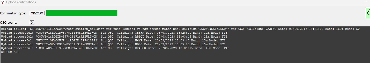

Just updated to v2.27.1.0.
Spotted that some other were having a problem with QRZ.com so thought I'd check.
External data lookup is working well but the auto-upload of QSO isn't working.
Using QSL Manager I selected the necessary QSO and tried uploading them.
QSLcom Capture.jpg (75.71 KiB) Viewed 3257 times
All but one uploaded well but the first didn't. Hope this is of help in finding the bug.
Regards
Mike G0KAD (GX3WSC)
