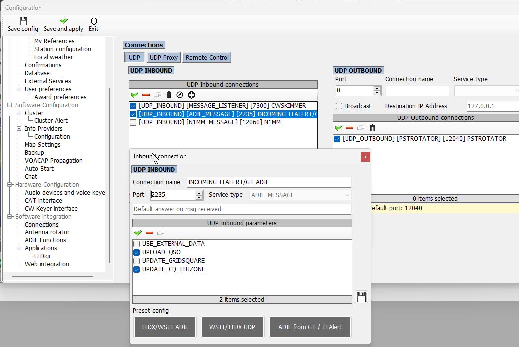

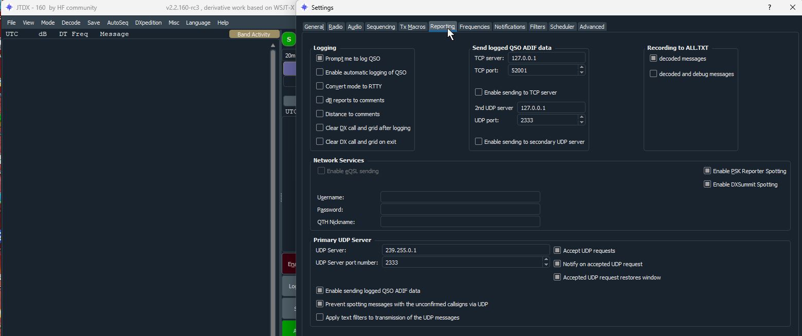

Hello Terry
Here I am back at the QRA
Some precisions :
1) My requests are to help radio amateurs who have problems
2) as far as I'm concerned it works very well for me
3) as it works at home, I try to do the same at my friends
4) it does not work for example with my friend F8NHF
5) the only thing I see is that I'm using a Broadcast address for JTDX instead of using the Localhost, but since it works fine I concluded that can't be the problem
here are the screenshots requested, I will make 2 posts to show all the screenshots:

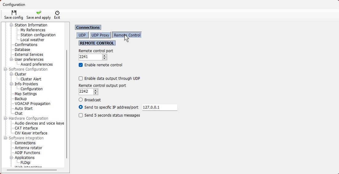

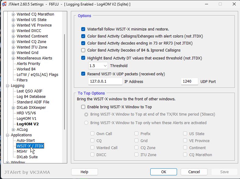

following screenshots :
In JTAlert we have a setting of Resend WSJT-X UDP packets (received only) (In Settings/Applications/WSJT-X/JTDX) with 127.0.0.1 and UDP port: 1240
And
in Log4OM there is no connection with this port 1240?
Would that mean that port 1240 is useless?
Thank you very much Terry if you can look at all this and guide me, it will help a lot of friends
The other question I get asked that I don't know how to answer is:In JTAlert we have a setting of Resend WSJT-X UDP packets (received only) (In Settings/Applications/WSJT-X/JTDX) with 127.0.0.1 and UDP port: 1240

Re: UDP connection problem
From my research that is so JTAlert can resend UDP packets from WSJT-X to other programs. But it appears that JTAlert is already setup for Log4OM; so I don't think you would need to have the packets repeated. If you do...it should just be a matter of setting it up as another Inbound Connection.

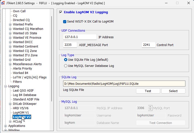

Dan,
If you recall I posted the JTDX and LOG4OM set up windows earlier in this thread which you found worked fine for your friend.
Firstly I prefer the UDP connection to JTDX to be the JT Message instead of the ADIF_Message and you found that worked OK
By introducing JTAlert you have started to duplicate logging so you should either dissable the JTAlert logging to Log4om or dispense with the UDP connection to JTDX - Dont use both
I understand that JTAlert is a great program to alert you to required contacts and it does maintain its own internal log I beleieve so ther eis no reason to stop using it just dont double up on sending the QSO's to Log4OM

Correct except number 2
Just dissable Log4OM V2 Logging to SQLite file but leave port 1240 enabled

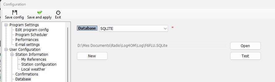

2-1 Yes no selectionF6FLU wrote: 12 Apr 2023, 07:35Thank you Terry
2-1) this means that in the Log4OM preferences (User Configuration / Station Information / Database
I don't select my SQLite file?

2-2) This means that in JTAlert I leave "Resend WSJT-X UDP packets (received only ) validated with port 1240 (JTALERT Settings/Logging/WSJT-X/JTDX)?

2-2 Yes
2-3 Inmaterial the port is used for other things
2-4 No
