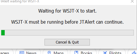

kay with rich's help {kd0zV) I got the udp part working and all was okay for nearly a Month. In that time I did not come back to the forum (which is a mistake) and now I am trying to catch up with what has transpired over that time. Now JTAlert will not start with the following message. What has happened over the last month to cause this?

Re: 2.27.1 Not working
I dont think this is related to Log4OM.
This looks like a connection issue between JtAlert and WSJT.
Make sure that WSJT is running and you have the 3 boxes checked under the UPD server and the ports set correctly per JTalerts instructions.
Do all this without Log4OM running.
Once those two programs are working together without issue than you can start Log4OM. Verify in Log4OM that you are NOT using the same UPD port you setup in JTalert and WSJT.
