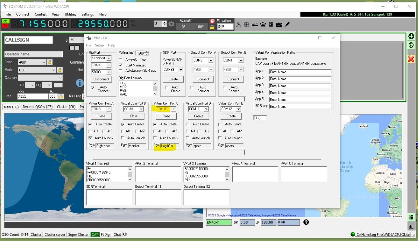

No joy with Omnirig. The issue may be that I'm using the free LPB2 USB data sharing software. I have 3 virtual ports (8, 9 and 10) and connected to the real physical port (COM4) from the 890. Everything works fine except the MR freq in Log4OM.
WIth the LPB2 sharing COM4, I can use any digital program (JS8Call. WSjit-X, FlDigi and Winlink Express (all programmed to use COM8) with Log4OM using COM10 and it's golden. Radio QSY, mode, display all work as expected (I only use 1 of the digital programs at a time + Log4OM).
I don't know if the issue is with Hamlib or LPB2. LPB2 is spec'd that only the first com port (in my case, COM8) has full functionality. It's an old program, but it works great for sharing 1 USB port to many Windows programs.

Why do you need LP Bridge especially when by their own admission they admit to not supporting 32 bit text fields, so what causes you to use that software?
My friend Robin used to slavishly use LP Pan and LP Bridge but now has simplified his setup and these are obsolete when using his variouse radios, amplifiers, rotators etc
