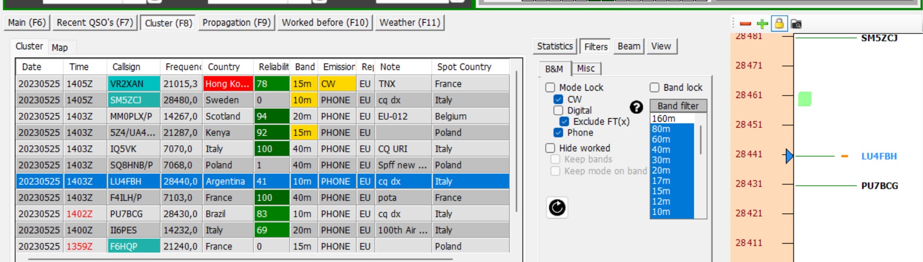

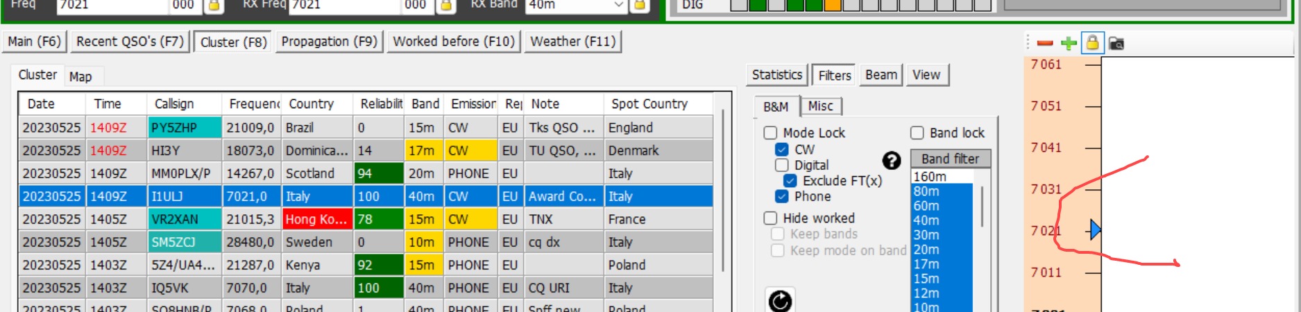

Maybe I was not clear enough, Have a look at the 2 jpg. For the ssb we can see stations in the right window. But for cw not any station is visible in the same window! Why?????

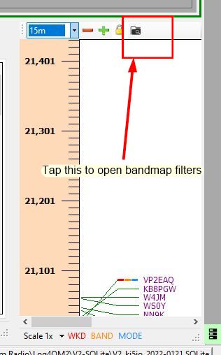

It is about the filters chosen. Each bandmap has its own set of filters to choose from.
See images below.
