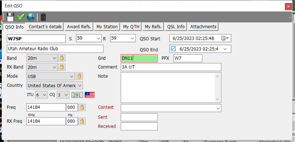

For reasons unknown, my QSO grids are incorrect. For example, when logging field day contact this weekend, W7SP in Utah displays a grid from Nevada (DN11). The correct grid is DN40.
I noticed the problem when using a QSO mapping tool. Many of my contacts were incorrect. For example, I had zero contacts in Nevada, but several in Utah. Because of the incorrect grid for the Utah station, it maps to Nevada.
Is there an automated way to refresh the grid squares my my previous contacts? This weekend was 500+ and not an easy process to validate and update each one.

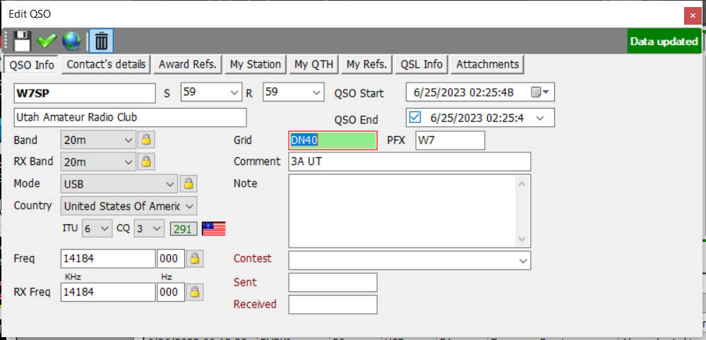

I also cannot change the REALTIME LOGGING and HISTORIC QSO settings. There are no drop downs.
When I select the globe to update the QSO, it populates with the correct grid.
However, when I use the QSO manager, the grid does not change. V2.28 & Grid Squares

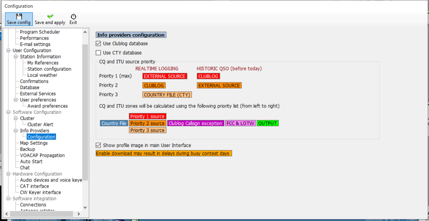

The changes to Realtime Logging and Historic Logging were made with V 2.24.0.0 and V 2.26.0.0 ... this was due to so many options that ended up conflicting with one another and giving virtually everyone bad / incorrect grid IDs. Using certain sort order settings was causing a lot of issues.
Lele made the changes after we tested for well over a month and have not had any issues since that time.

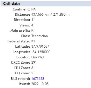

Screen clips below show two lookups I did for w7sp ... one with my QRZ.com "XML Subscription" and the other with my "free" login at HamQTH.

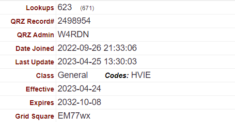

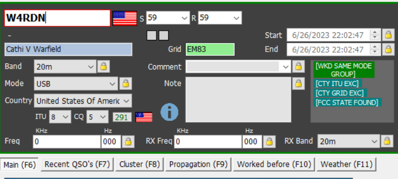

Ok, here's a headscratcher ... I have my info providers selected for QRZCQ only as 'primary' and 'web external source'. I also have CTY enabled.
For this test call sign, W4RDN in EM77WX, Log4OM returns EM83 (in Georgia). When I look the call sign up @ QRZ and QRZCW, the call sign grid is EM77WX.
If I untick CTY, I get no grid detail. I presume EM83 is a common grid for W4*
I must have something misconfigured in the settings because Log4OM will not return the correct grid location.
Re: V2.28 & Grid Squares
If you dont have an XML subscription to QRZ you do NOT received a locator from QRZ
In the absense of a locator being found using the online source Log4OM uses internal data to select a locator at the aproximate centre of the country indicated by the call sign prefix
