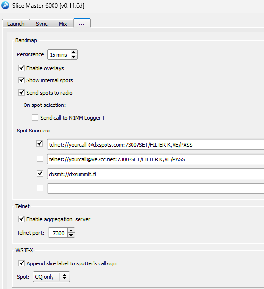

I use a utility "SliceMaster 6000" with my Flex 6600, it has a aggregation server to aggregate spots from multiple servers and WSJT-X. I then point Log4OM to the aggregation server for spots. Works perfect, see all decodes or just CQ decodes from WSJT-X.

Thanks Ron--I'm using slicemaster as well so that's exactly what I need to know.
