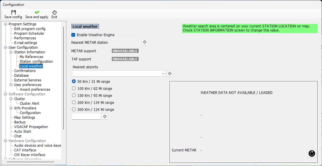

I ask for help... METAR data are not available for me... I cannot realize why.
This is config...
Screenshot 2023-08-03 232359.png (58.43 KiB) Viewed 2077 times
This is result...
Screenshot 2023-08-03 232457.png (65.49 KiB) Viewed 2077 times
It seems to be simply UNAVAILABLE for me... I live 10Km from LIRQ (Florence Airport).
Any trick?
73 de Leo IZ5FSA
Posts: 11581
Re: METAR DATA not loaded
Click the button to right of 'Nearest METAR station'
Posts: 11581
Was an issue with data sent in METAR, resolved in next release
iz5fsa
Posts: 9
Joined: 08 May 2022, 09:18
Location: JN53OS
Post by iz5fsa »
Only after af resh install METAR data works fine.
