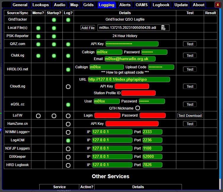

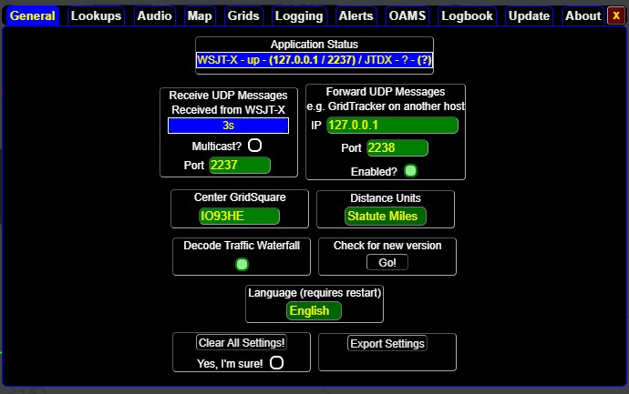

For some reason the settings used previously decided NOT to work and as I'd gone back to Win10 and then back to win11 the UDP connections had to be renewed.
So late last night I went back to watching K0PIR videos and used his settings exactly - YESSSSSS success at last, he also made the point of starting the programs in order - WSJT>LOG4OM>GRIDTRACKER, not sure if its important but whatever works....
I'll attach my settings (K0PIR) just in case it helps anyone else that's struggling
Cheers All

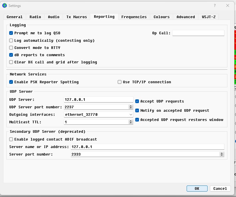

Re: Log4OMV2 2.29.0.0 UDP Coms
Not sure if this JPG loaded previously
- wsjt.jpg (101.2 KiB) Viewed 1668 times
