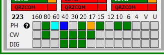

Your missing the light and dark blue colours which mean ...
Light blue - Actual call sign entered was worked before but not confirmed on the band/mode indicated
Dark Blue - Actual call sign entered was worked before and is confirmed on the band/mode indicated
Orange - I have the country confirmed on 17m phoneon the band/mode indicated, but not by the call entered
Green - I worked the country on that band/mode but its not been confirmed.
Grey - Country not worked on the band/mode indicated
See my example below, I worked the call sign entered on 60m but it is not confirmed - whereas I worked the same station on 40m and it is confirmed - Page 35 of user guide 'Statistics (F1) matrix'
Screenshot 2023-11-23 083931.png (4.16 KiB) Viewed 6661 times

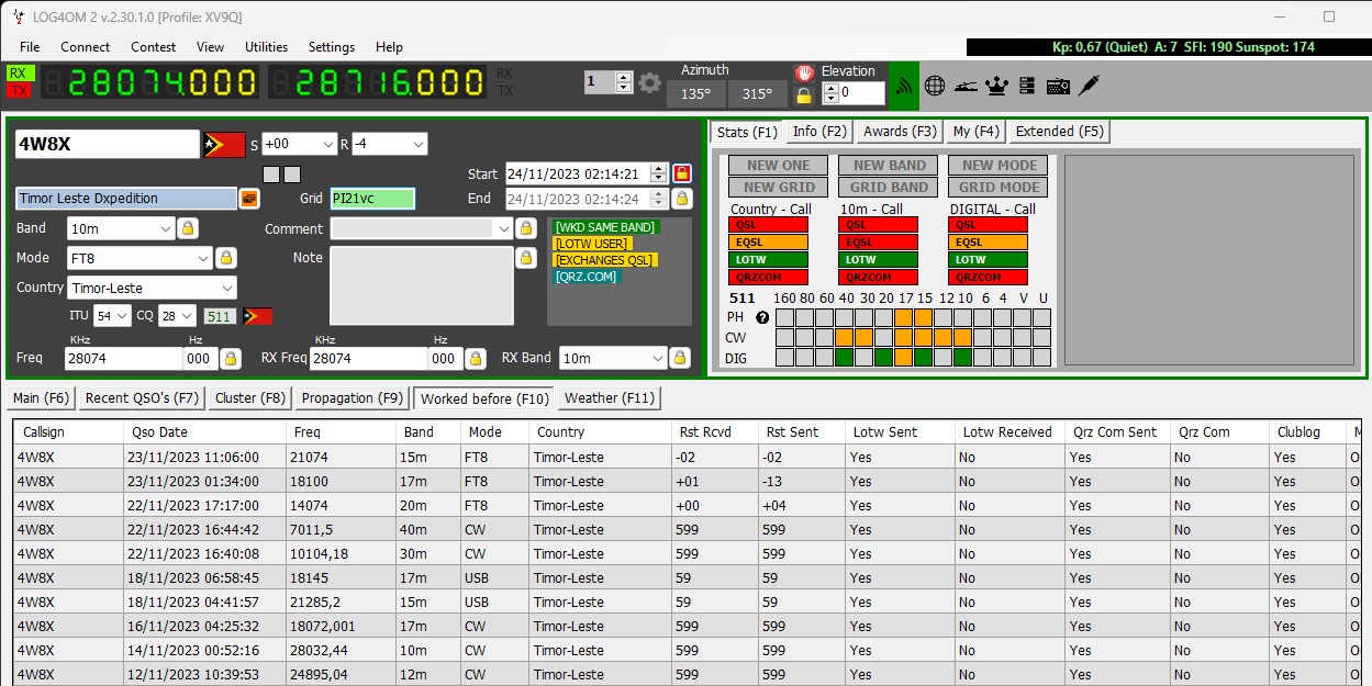

I have v2.30.1.0 but I have never seen blue for long time.
For example:
No blue here it is the same for all stations I worked I never see anything related to the call itself but rather the country.
As you can see the stats are for Timor Leste where I have confirmed already on 40, 20 and 10M Digi while the other orange are for most of them 4W8X but they are not in blue.
73 de F4BPO Greg

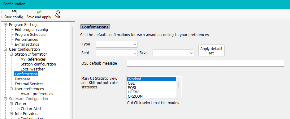

What have you got set here?

I have LOTW / QSL / QRZ
73 de F4BPO Greg
Posts: 11605
Re: Stats on a call
Change to worked only and see if you get blue squares
Seems that you dont have that station confirmed by any method and your set to just see confirmed QSO data in statistics

same

When I compare you screenshot with mine I see that below Country - Call / 10m - Call / Phone - Call it is red but it is missing the small square on the right which represent the callsign.
Where could this come from ?!
We clearly see the square on your screenshot not mine
