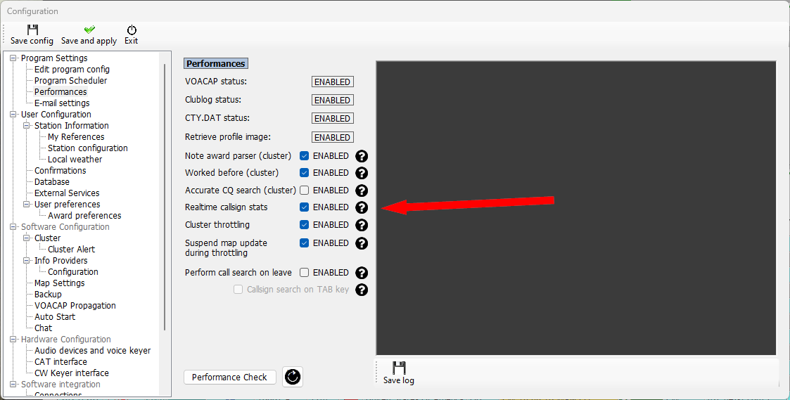

Do you have Realtime Callsign Stats 'enabled' in your Configuration / Performances?

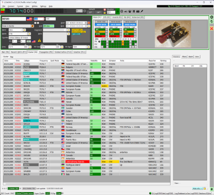

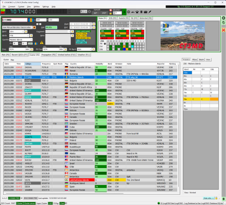

Thanks for the response - I'm running 2.29.0.0. I didn't download the latest yet because the fix it contains isn't pertinent to me. Yes, I have the item enabled that you indicate. So, you're saying if you manually enter a callsign into the call field, the grid to the right of the spots window ("Statistics/Filters/Beam/View") populates with your band/mode info for that entity? It does not for me unless I click on a spot in the cluster window. Then all the data is populated. This makes is useless for ignoring spots and doing my own RXing to try to nab one before it gets spotted.
Here, I have entered your call - no grid: Here, I have clicked on a spot, and the grid appears to the right of the spots window:
[attachment=0]2023-12-07 (1).png[/attachment
Just in case we're not talking about the same "Statistics" grid.

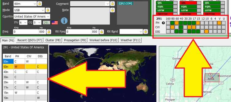

Only the two grids shown in the first screen shot are activated by manual entry

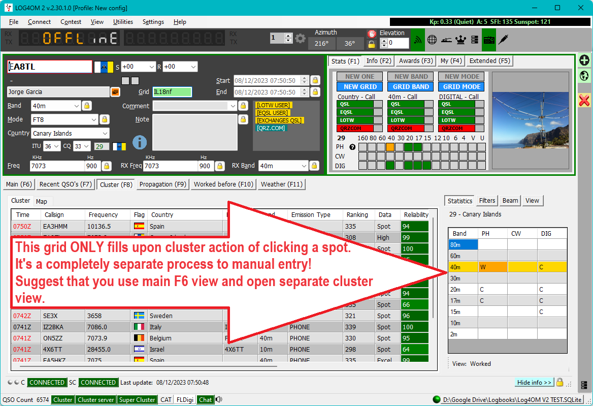

The grid in the cluster window as shown below only is actioned by clicking a cluster spot - Not by manual entry
Re: Statistics Grid data from manual callsign entry
OK, thanks, Terry - I'd prefer it in the larger view, but I see I can find the same info (after decoding colors) in the upper stats window. Somehow that just never registered with me.
