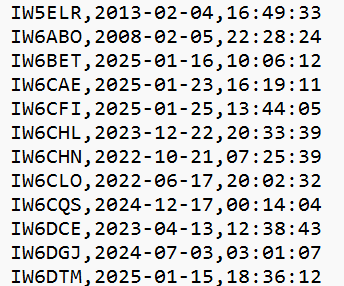

Posts: 11602
Re: LoTW user known how?
IW6BDE is not included in the download from LOTW which Log4OM downloaded today, that is why its not marked
Have you asked LOTW why they ommitted that call from the provided download but its in the on line file ?
We have similar issues sometimes with QRZ where the download API does not list info shown on the website.
I also note the on line file has a date fror that call having uploaded late this afternoon, has it ever uploaded before that one?
Screenshot 2025-02-02 174506.png (17.66 KiB) Viewed 2609 times
Posts: 11602
Follow up
A download of the LOTW file in Log4OM two minutes ago (2025-02-02, 18:01:32) now contains IW6BDE so I am fairly certain that the first ever upload of that staion was late yesterday afternoon at 2025-02-01,16:56:24, as noted in my last post.
