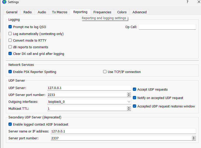

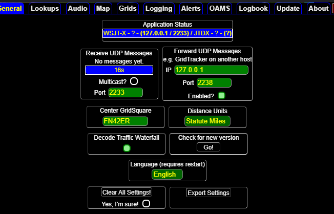

I don't think I have any conflicts. Not that I can tell at least. Here's my UDP configurations for WSJT-X, Log4OM, and GT.
Might be hitting a bug somewhere. It's not critical of course since I can still use QSL manager in Log4OM to update QRZ. I prefer to let Log4OM perform the uploading to external services versus using GT. GT can do the upload to QRZ but that leaves my log entries in Log4OM with a QRZ status = no. I should run more verbose troubleshooting logging in Log4OM to see why Log4OM will not initiate the upload to QRZ if GT is running.

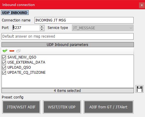

What options have you selected "inside" the UDP Inbound Parameters?
There are 4 to choose from in each UDP Inbound Connection.
'Sample' below just to show the 4 options you can enable or not enable.

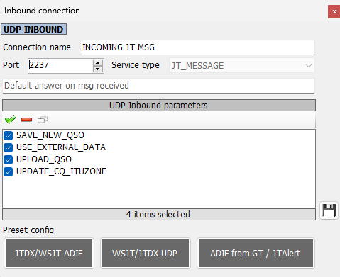

Hi Nolan.
Here are my Inbound Connection settings for each of the 3 entries.
--Chris

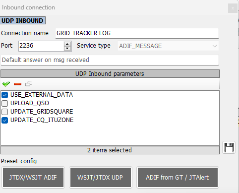

You do want the "UPLOAD_QSO" option ticked in your UDP INBOUND "GRID TRACKER LOG". While you're seeing this as an "outbound" issue because Log4OM isn't pushing data out, the "inbound" perspective in this case is "inbound to Log4OM" (from Grid Tracker). <-- That's what I'd left unticked on my own setup, and that single change sorted things out for me.

In the images from November (which you may well likely have changed since then), WSJT-X's "Secondary UDP Server" is pointed to port "2337" while Log4OM is listening for "INCOMING JT MSG" on port "2237" -- that said, I think you probably want Log4OM to be listening for WSJT-X's "ADIF MSG" to update the log instead of the JT MSG.
If you've figured it out, I'll clean up my speculation here for the sake of leaving a clean record of resolution--if you haven't, try setting WSJT-X's Secondary UDP Server to port "2236", and in Log4OM do tick the "UPLOAD_QSO" parameter in "GRID TRACKER LOG" for port 2236 and see if that makes things work.
