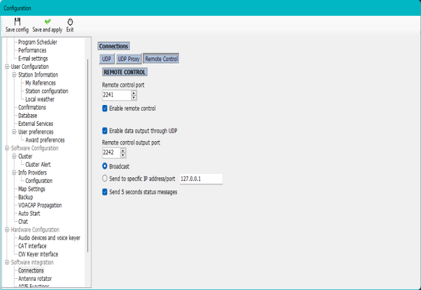

Re: LOg4OM populate callsign in Entrywindow from JTDX?
Post by lb3re »
i tried this also with 2241 as JT message in JTDX, but still no appearing in "remote control" gives callsign in entry windows with 2241 in LOG4OM ... :D

Posts: 11616
Something using that port perhaps?
lb3re
Posts: 20
Joined: 06 Apr 2018, 13:52
Post by lb3re »
No, i tried to restart my computer and have only JTDX and LOG4OM active.
I dont see why this would not work.. I tested in TWO other computers and it works
Posts: 11616
Try changing port numbers in both programs
