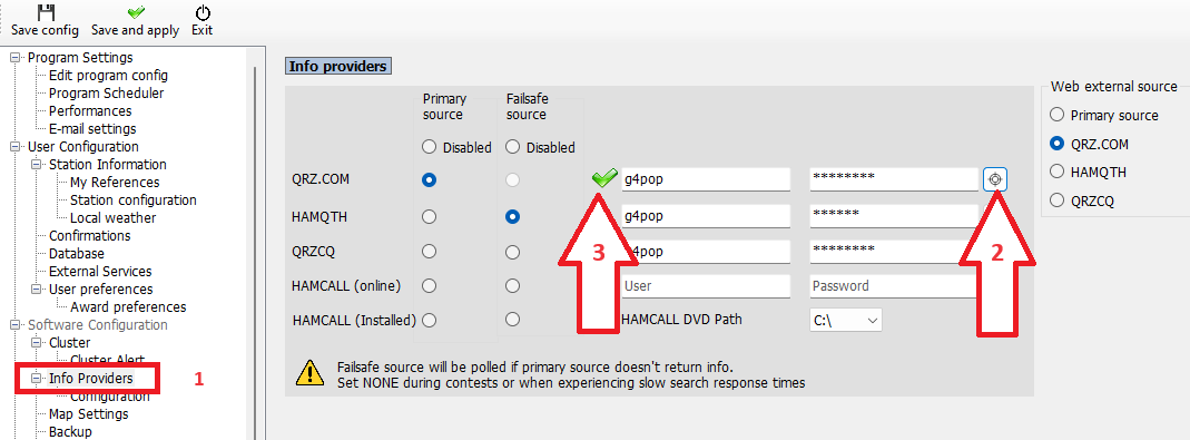

Have you tested the QRZ connection in config/info providers, does it show a green check mark?
The API code is only used for upload to QRZ

I did say in Config/Info providers and of course I refer to Log4OM, however here is a graphic
If you dont get a GREEN check (Tick) then either your QRZ user name or password are incorrect
Password - NOT API code

Ok Terry I got it working,looks very good,very well written program,thanks again
