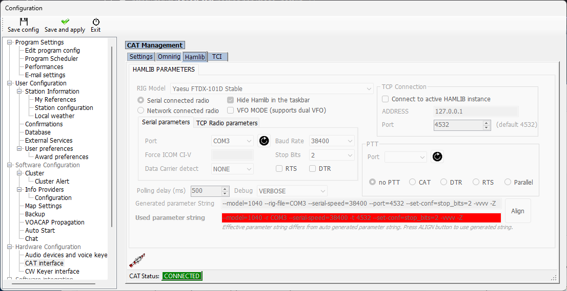

During holydays I've spent my time to reach a goal: setup hamlib CAT interface on LOG4OM + FLRIG + WSJT/JTDX. I've spent time handling Configuration / CAT Management / Hamlib / "generated parameter string" by hand with rigctl and rigctld in verbose mode.
Errors found in rigctl/rigctld params:
  • "--port=4532" that is not recognized and must be changed with "-t 4532";
  • "--rig-file=COMx" must be changed in "-r COMx".
Another error occurs, but it depend on my personal config for the YAESU FTDX101D/FY991A: the "--set-conf=stop_bits=2" is not recognized but can be omitted with no impact on radio use.
Setting up LOG4OM CAT interface with hamlib with right params...
Screenshot 2023-08-21 214318.png (77.15 KiB) Viewed 4341 times

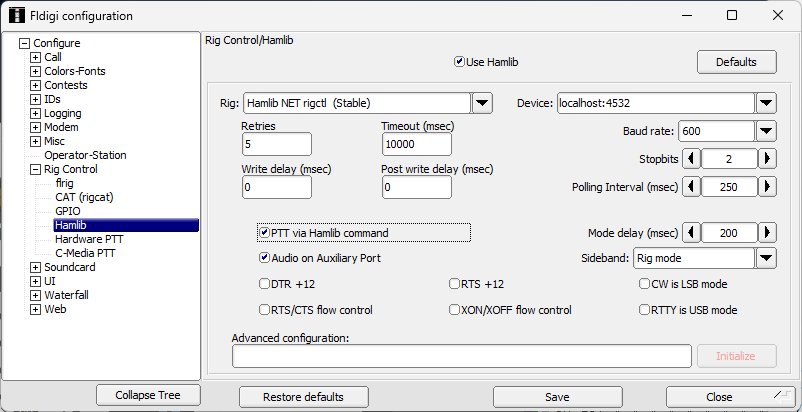

You can set up FLDIGI CAT interface using "Hamlib NET rigctl (Stable)" in Rig definition, with "localhost:4532" string in Device field cleaning Advanced configuration field...
Screenshot 2023-08-22 204407.png (34.47 KiB) Viewed 4323 times
and with other Log4OM/Fldigi setup all woks fine (double click on Log4OM spot set up frequency/mode on radio and also on FLDIGI plus callsign in the spot!

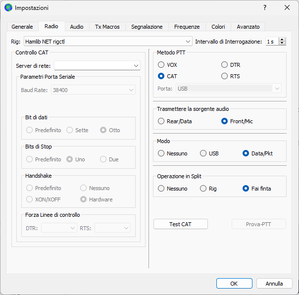

Screenshot 2023-08-21 214928.png (34.48 KiB) Viewed 4341 times
Using this setup don't need any serial port splitter added.

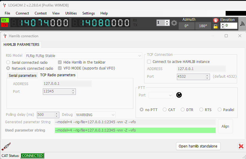

You've done it the hard way
Set up FLDigi to use FLRig
Set up WSJTX to use FLRig
Set up Log4OM to use FLRig
Screenshot 2023-08-27 160040.png (50.7 KiB) Viewed 4292 times
