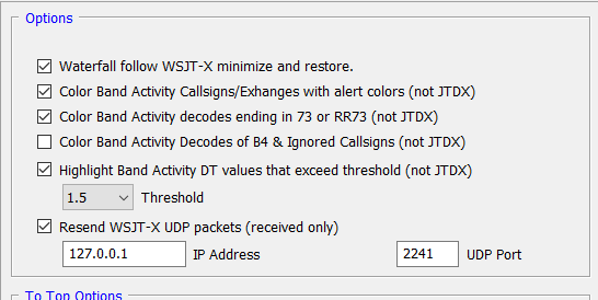

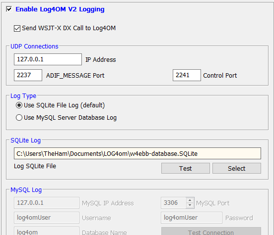

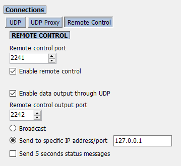

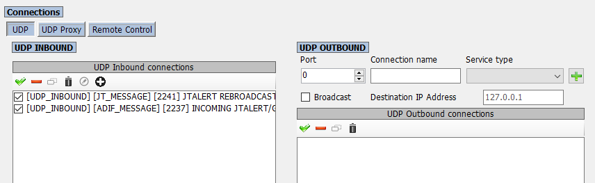

Your Log4OM UDP port numbers don't match the ones from jt software!

Here are some snips of what I have set for the UDP. I just can't get it to log. I could only attach 3 screen shots, so I will include the other 2 in a second reply message.
2024_0330_jtalert logging.PNG (16.95 KiB) Viewed 2976 times
2024_0330_jtalert applications.PNG (13 KiB) Viewed 2976 times
2024_0330_wsjtx settings.PNG (17.06 KiB) Viewed 2976 times

Here are my other 2 screenshots...
2024_0330_log4om remotes.PNG (9.34 KiB) Viewed 2975 times
2024_0330_log4om connections.PNG (15.57 KiB) Viewed 2975 times
