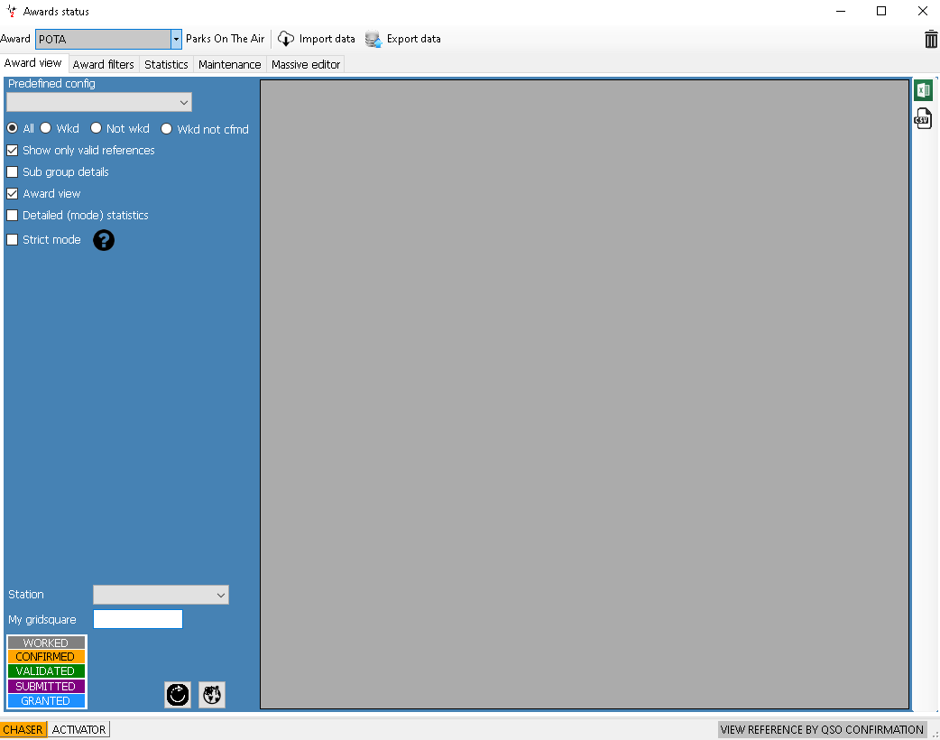

I went to see how many POTA I have. I noticed not all was listed under [view] [award status] there was ten or so I knew I had more. I went to the manual and found on page 173 to 174 it talked about POTA. I interpreted it as possibly needing to update as in Step 1. Well now there are no POTA listed under Award Status it is completely blank. I didn't check Step 8 that is the only thing I didn't do as I thought I haven't updated before. I geeked on that as I was merging an update to an existing data. I like to get this straighten out as I love POTA contacts and plan to activate parks in my area.
Thanks Again everyone for the help ahead of time.
POTA completley blank

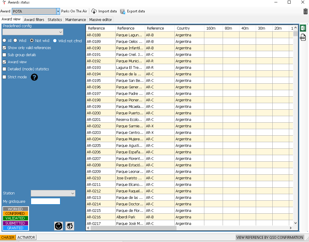

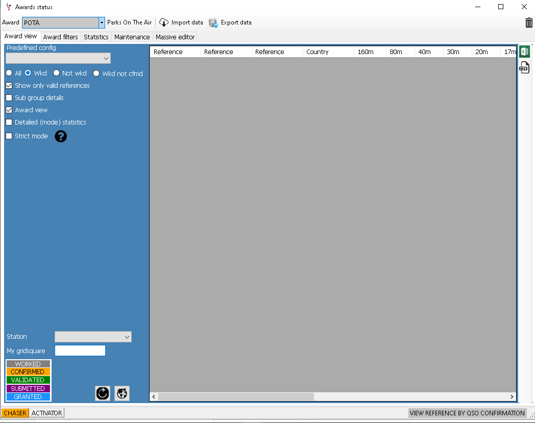

Thanks Terry
I did what you listed. I now have all POTA Award Status Award View under All when checked lists all the POTA but is still doesn't show under Wkd my worked parks. What populates this when checked? I'm thinking a field on my log doesn't have the right info, but it should fill it in automatic. The Not wkd list all POTA but the Wkd and Wkd not cfmd are stillcompletely blank with no listing of even the parks.
I still trying to digest the link you provided. LOL Is that why it's not populating POTA Wkd and Wkd not cfmd?
Thanks again for the help.

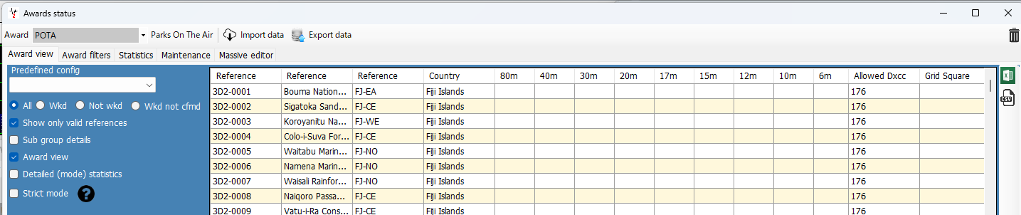

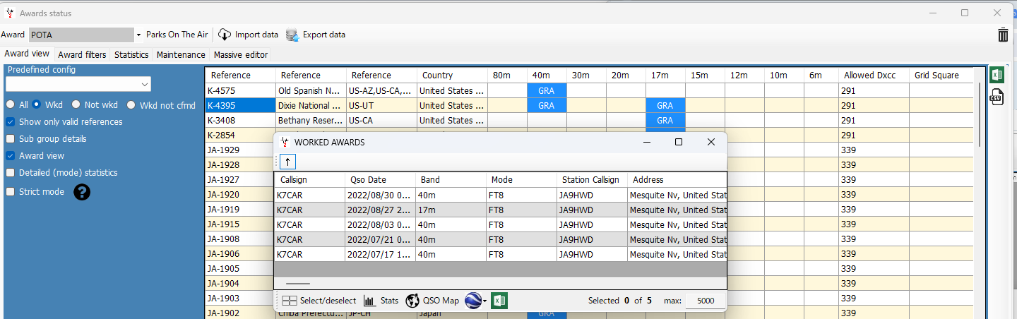

I can't imagine it taking that long. I'm wondering what kind of problem there is, but this screen will appear after a short wait.
Do you think it is correct to display the following in the current award database?
This screenshot shows the old code of the current database and the result of inputting Sig and Sig info for each QSO. POTA users will enjoy it.
I hope the database will be able to support the new code soon.
