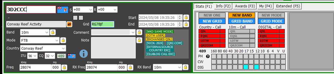

Re: 3D2 Conway Reef
Hi Peter,
I cant replicate the problem here using a manual entry of 3D2CCC on the same bands and mode, see screenshots below
Have you tried a manual entry instead of the UDP update from WSJT?
Conway two.png (3.19 KiB) Viewed 3513 times
Conway one.png (11.6 KiB) Viewed 3513 times

Posts: 11617
Re: 3D2 Conway Reef
Hi Peter,
Very odd, I even installed WSJT and tried an FT8 contact via UDP and that worked fine also for same call!
Try 'Rescan Award References from the View/Award status/DXCC award 'Maintenance' tab

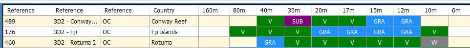

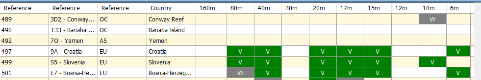

Posts: 11617
Re: 3D2 Conway Reef
OK so the issue was none of the other 3D2??? QSO’s were with Conway Reef, they were marked as Fiji with a different DXCC ref, see below. Some pre date Log4OM so probably were imported some years ago.
Probably some other QSO's also recorded as Conway Reef which should not be?
