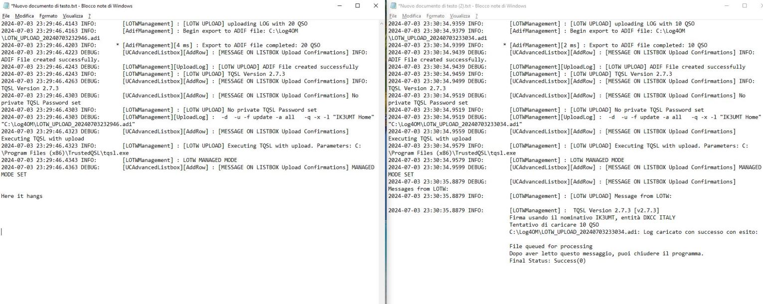

10 qsos are uploaded ok
20 or more upload freezes (I didn't try where the limit is , 11 rather than 19...)
I enabled log tracing but nothing seems involved.
Attached is a side by side log of failed and successful operation.
Of course the LOG4OM generated adif file (also one with 1000+ qso) is correctly loaded when using TQSL program manually.
Any suggestion ?

- log.JPG (182.37 KiB) Viewed 1998 times
