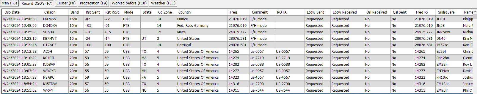

here is an example of adding 'F/H mode' to my FT8 qso's.

Looks like your ft8 software is ending that data to log4om, we don't add it

Regarding "comment", Log4OM2 should not be processing anything.
You are probably entering comments in the WSJT-X log dialog. This will continue unless you delete it. Or it's in the continuous display settings related to JTAlert's comment display process.
If it is displayed on the QSL card, it depends on the JTAlert settings. This is different from the "QSLMSG" tag that is usually written on QSL cards.
JTAlert is processing to avoid a bug where comments are not set correctly in the WSJT-X "QSLMSG" tag, so please be careful when setting.
I think it's probably written in the JTAlert help.
73, Kiyo JA9HWD
