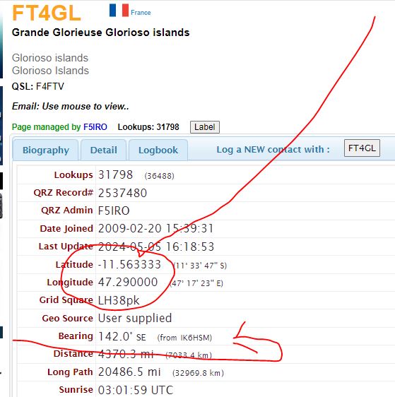

Azimuth (short and long path) and coordinates are not the same thing...
what i'm missing?
Re: azimuth from provider
IW3HMH wrote: 20 Jun 2024, 07:32 Azimuth (short and long path) and coordinates are not the same thing...
what i'm missing?

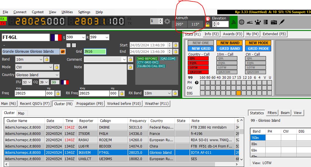

He is using the wrong grid in Log4OM for station so beam heading is incorrect
He suggests calculating the other stations location from lat and lon instead of using imported grid
I did not answer this because he has an incorrect grid ref in Log4OM not the one retrieved from QRZ
Also seems to be using a very old version of Log4OM as there is no data or version number above File, connect etc

thanks for the help ,
Sorry, I'm reading the manual but...I'm behind
in fact I hadn't noticed the grid (I didn't insert it)
I don't remember the log4om version, certainly the most recent no beta.
Now I use 2.32.1.0
and thank you again
