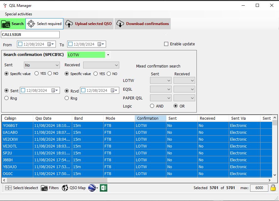

If you watch the videos I mentioned earlier and read the user guide you will understand that you can select the QSO's which have NOT been uploaded in the QSL manager and then just upload those QSO's only - Thus avoiding dupes on LOTW

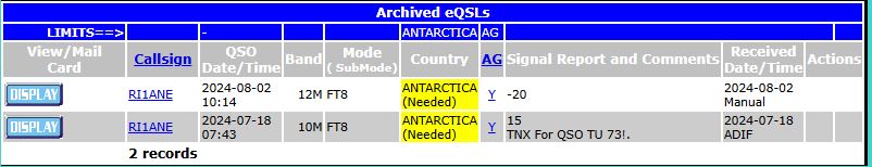

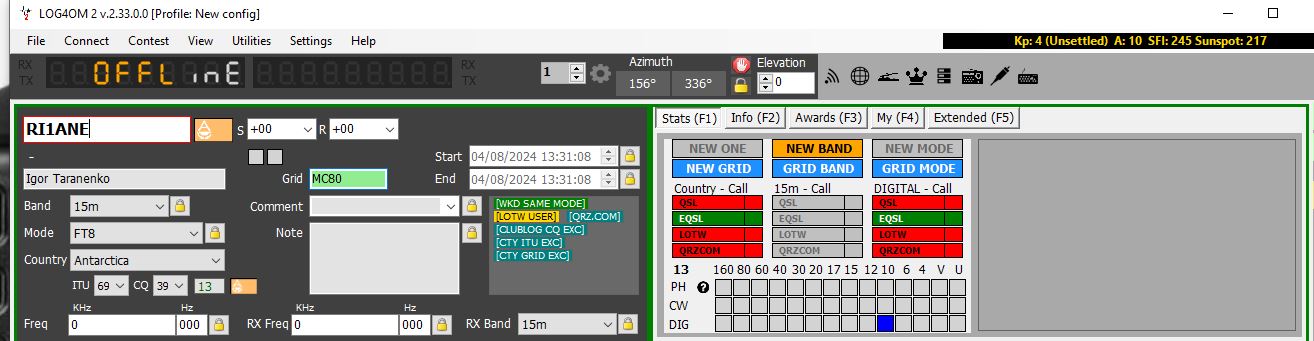

watched the videos went in to log4OM did what it says i didnt do lotw but i did do eQSL i am a little confused as the user RI1ANE from Antarctica i have worked twiccw on 10m & 12m confimed on lotw & eQSL but on Log4OM it only shows 10m
Posts: 11586
Re: LOTW syncing to Log 4OM
Have you done a full download from LOTW and eQSL?

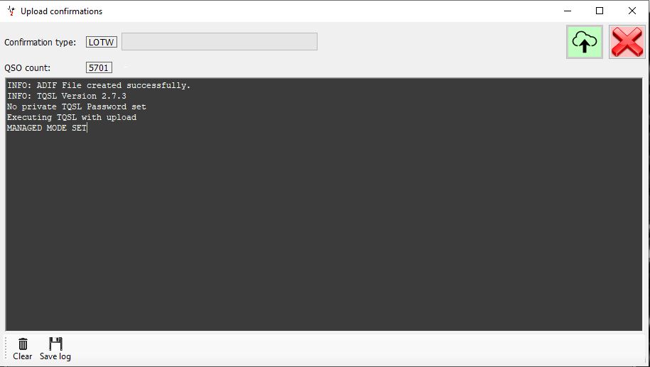

Watched the videos over and over read the user guide/ manual but still a little bit dubious as I don’t want dupes in my lotw , when doing the upload it takes a few minutes then tells me it is done then when I click the upload button in the 2nd window it tells me a adif is successful then when I click the upload button as I have a lot it takes ages I left it for 2 hours last night and nothing on the progress bar

just took a few screenshots of what i do maybe its easier for you guys to understand ....lol i am a Brummie

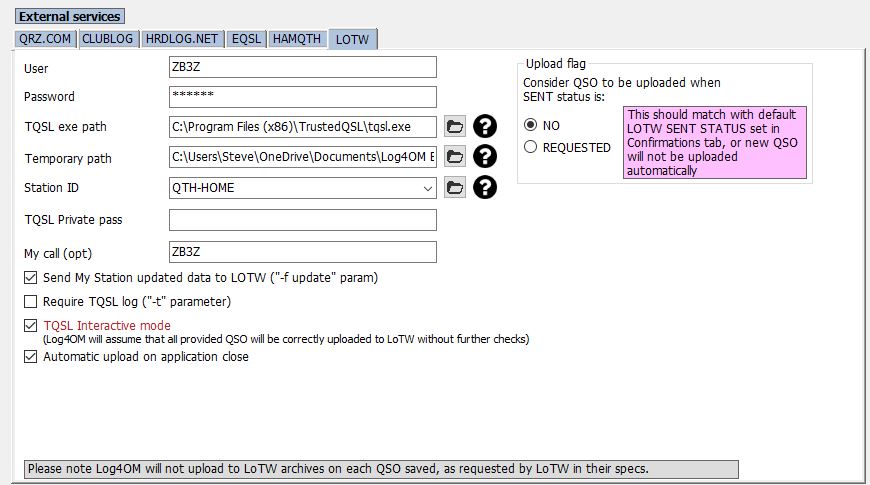

I think i have done all that Terry in my log they are all coming back yes then waiting for a reply on eQSL or LOTW , the only problem i have now is which boxes do i select in External Services LOTW
