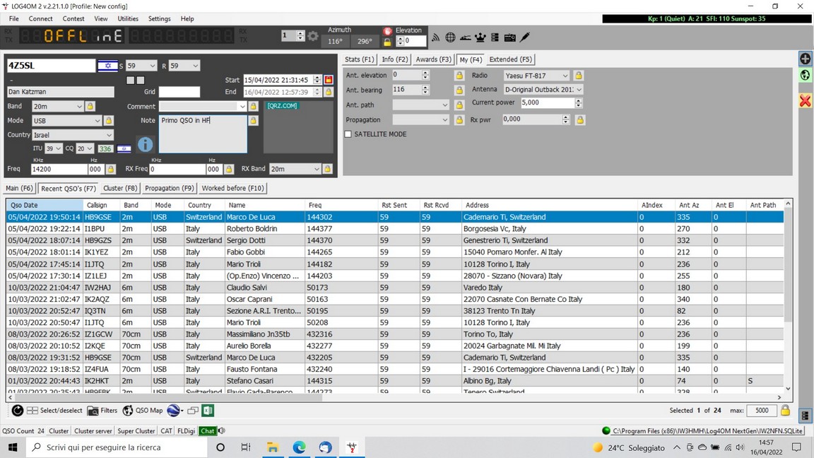

I have some problem to save a new QSO
As a image that I attached ...I fill all information in the QSO box...but when I click the + button on the right of the monitor...all information in the box are deleted but the QSO will not save...
What is the problem?

Re: Not save new QSO
Check the log file it will recorded what happens
I´m shure that the QSO is saved if you hit the + and you don´t get any error message in a popup window.
Below the QSO list on the left you see the little refresh button. Hit it and the QSO list will be refreshed.

Yes I already hit the button on the bottom but... I never don't see my new qso

Your logfile says that your database is read only probably because you have saved it to the 'Program files' folder of similar

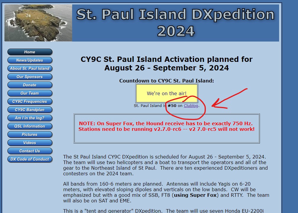

after having clicked on the link to Clublog on the CY9C site that I had just connected to, I unfortunately introduced a virus into my PC which is blocking all the folders on the system, changing them to read-only even though I correct them. obviously for this reason Log4OM cannot reach the database folder. so the problem must be looked for elsewhere and not on Log4OM. warning only to spread the information
