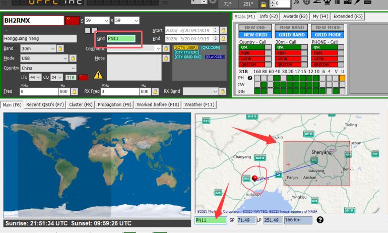

Thank you for your reply. I followed your instructions. But the result did not change. Look at my screenshot. In addition, 4-digit and 6-digit grid display, is your display 6-digit? Is your recorded grid data correct? My software shows PN11, which is wrong.py8ml wrote: 20 Mar 2025, 02:31 Good evening everyone!

Problems with callsign search and MAP locator is not correct

Your QRZ account is a "paid" account. If it is not, you will not get the correct information. Oh yes, check QRZ.COM as "Primary source" on the right side of the screen where you marked with the red arrow

Hi BH2RMX,
Here's how my screen looks when I enter your Callsign into my log4. Everything is correct.
So this makes me think that what's happening is that your QRZ.COM account is not a paid account and maybe that's why the integration with Log4OM isn't perfect.
Am I correct?
Am I correct?

Its more likely that the grid reference is being received from an external program like WSJT and we dont change a users incoming data because we consider that that is the information he wants recording.
Its possible that we might overwrite the grid if 'Use external data' is selected in the WSJT UDP connection I dont remember.
However as you displayed Log4OM is providing correct lookup info as long as the user is a paid XML subscriber to QRZ which BH2RMX is NOT, he is a 'Ham member' not XML subscriber.

Thanks PY8ML,You made me understand completelypy8ml wrote: 21 Mar 2025, 11:54 Hi BH2RMX,
Am I correct?
