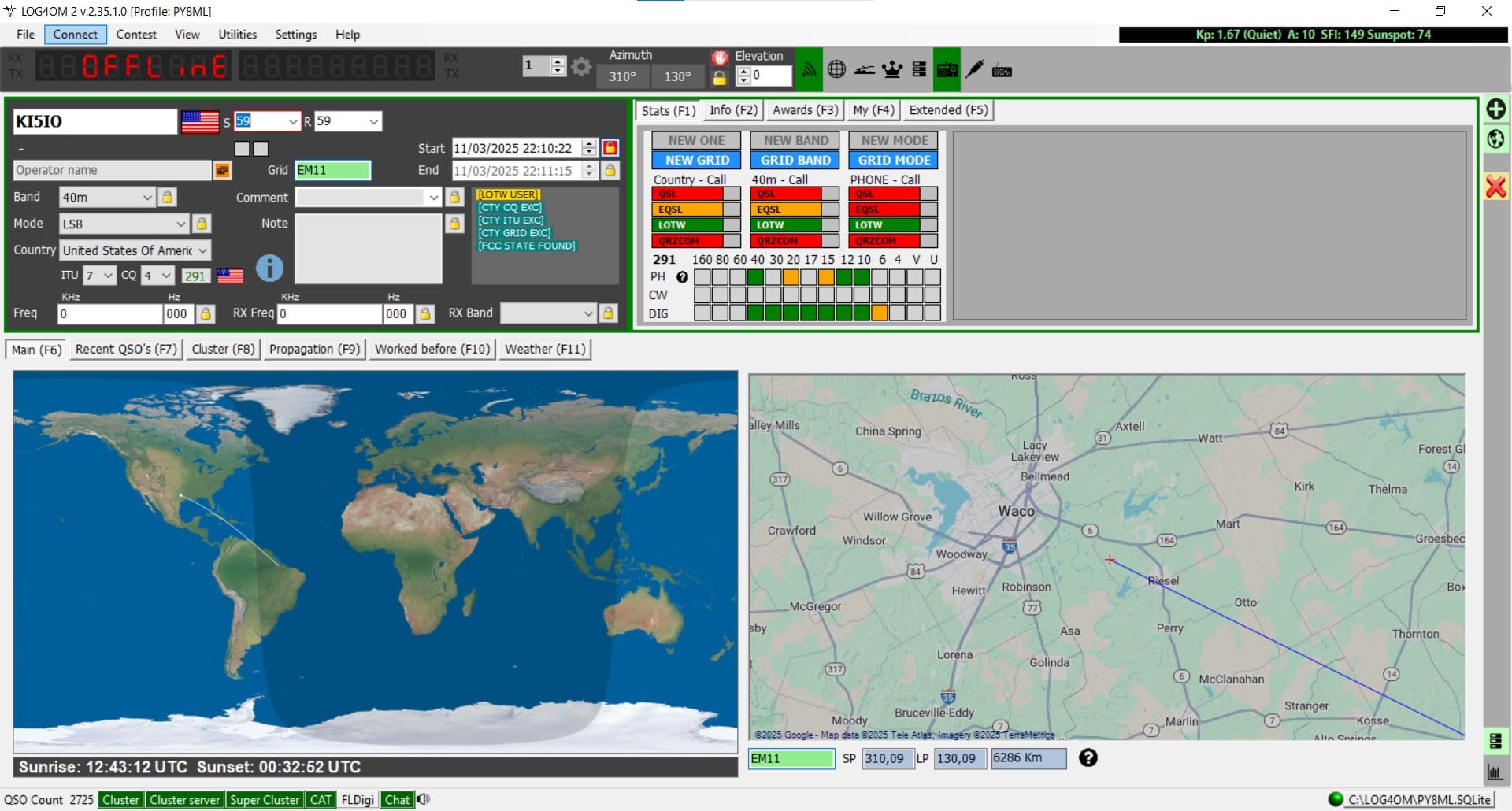

Mur,
Image below shows what I get when I enter in your callsign. I have a 'paid for' XML subscription with QRZ so that provides me with a bit more than just the basic information from QRZ.com.
Note the map indicator goes to the middle of the given grid square that is provided for your QTH: GI58sm
As for the Main UI filling out the information like name, etc. Everything filled in very quickly without any delay. My internet is via fiber optics and I have a reasonably fast upload/download rate.
- PY8ML.jpg (75.23 KiB) Viewed 6846 times

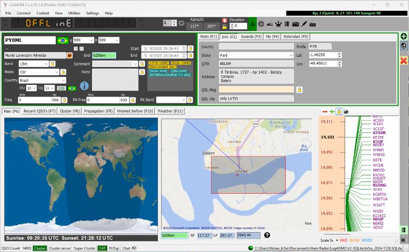

Re: Problems with callsign search and MAP locator is not correct
See what happens when I search for another random callsign...(screen 1)
See what happens when I try to search for your callsign (screen 2)
- Captura de tela 2025-03-11 192312 (1).jpg (181.18 KiB) Viewed 6146 times
- Captura de tela 2025-03-11 191206 (1).jpg (194.12 KiB) Viewed 6146 times

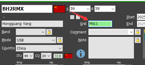

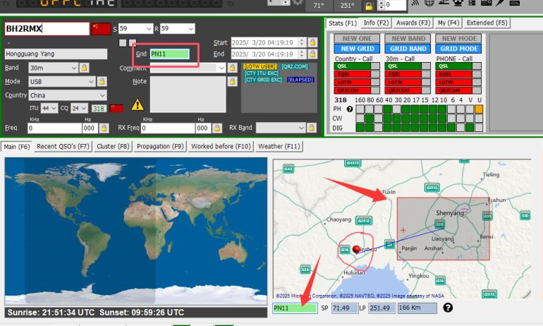

after 'Save and Apply' and also restart Log4OM,,No change, still 4 digits In addition, I set the info providers to hamqth,I don't understand why qrzcq keeps failing to authenticate even though I'm sure the username and password are correct. but the location grid is still wrong. The software shows PN11, the correct one should be PN01NC.What should I do? Thank you

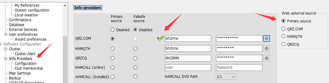

BH2RMX,
Test in LOG4OM if your QRZ password is correct.
In your last "print! I see that you did not mark the QRZ.com option as "Primary Source".
First you must do this, and then enter the login and password information.
To see if everything is correct, after you have done this click on the box to the right of the "QRZ.COM" line and see if the "green check" appears (as it appears in the "HAMQTH" line).
Thank you for your reply. I followed your instructions. But the result did not change. Look at my screenshot. In addition, 4-digit and 6-digit grid display, is your display 6-digit? Is your recorded grid data correct? My software shows PN11, which is wrong.py8ml wrote: 20 Mar 2025, 02:31 Good evening everyone!
