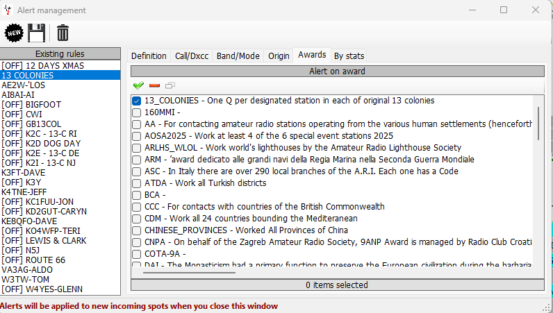

I was thinking I could filter based on "Alert on Award Table" as I have setup the 13 Colonies Event as an Award..and the award tracking works great. The problem is I don't know how to have that Award show up in the list of Alert on Award in the Awards Tab of Alert Management. I don't see any way to affect that list and don't know how it is generated.

Which then leads to the reason for my original post. One of the limiting criteria for alerts is Award based. Unfortunately my custom 13 Colonies award does not show up on the list generated in the Alert Management tab. Ergo I was wondering how to get it to show up, if that is even possible.

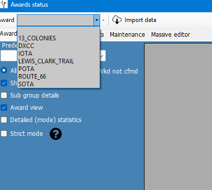

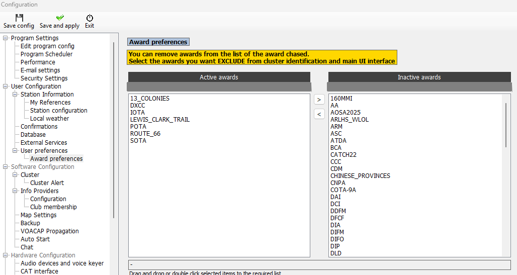

Here is a screen clip of my main Awards chosen that I follow. I've also added the Award dropdown visibility in my Alert Configuration.

Thanks for the nudge. Briefly, the award showed up on the Award List in my Alert Management tab after I created a second instance under a different name (Orig was 13COL, Renamed to 13_Colonies. Then it disappeared. I must have something not quite kosher. I've been through it several times without finding the witches brew needed to make it appear on the list.
Something is flakey. I'm not sure it is worth the effort to get it working as the event is all but over. :(

Whatever personal award you create you need to also (if so desired) to move it to the "active" column of awards ... as is shown in one of my added clips above.
I have gotten very 'selective' as to which awards I show on a daily usage basis. I can always add WAS, WAC, etc., etc.. when I want to see such, but try to just keep the awards of interest to me at the current time in the 'active' column.
Once in that column then they 'should' appear in all such related dropdowns in Log4OM.

User Preferences: I had noted that on your graphics and confirmed that I had it set the same. Still no joy.
Thanks for the assist. I'm sure it is some obscure setting that is causing the issue.
