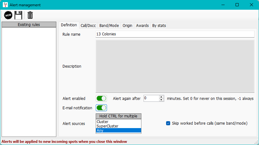

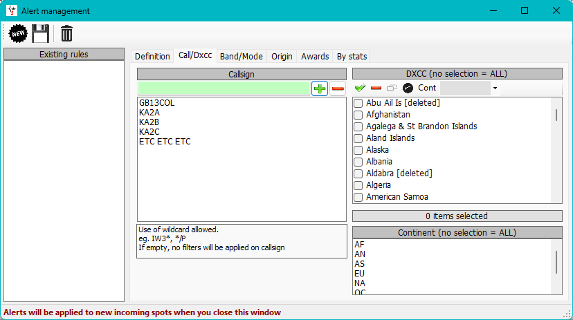

Not neccesarily the end story!
If these special staions use the 13col ref as their call sign just set up alerts for those calls as below
13 second.png (27.21 KiB) Viewed 17 times
13 first.png (34.81 KiB) Viewed 17 times
It sometimes pays to apply the 'KISS' principal
Your date range idea has been added to the list, TU

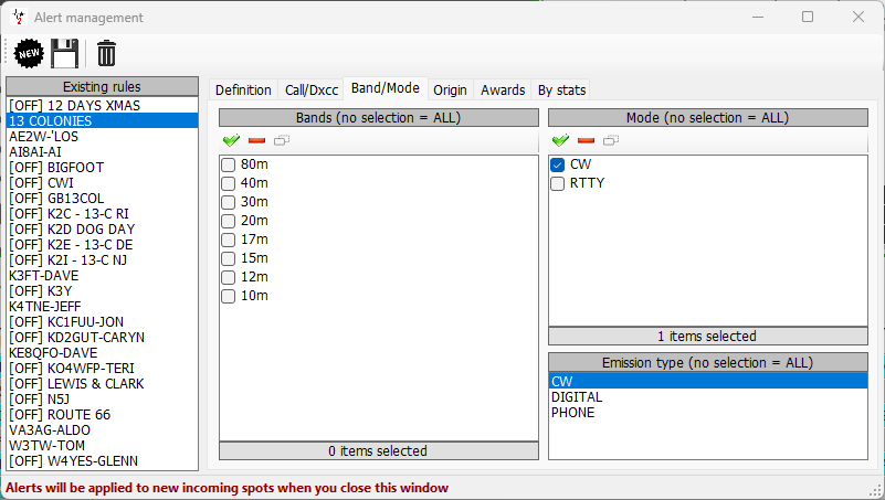

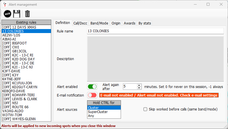

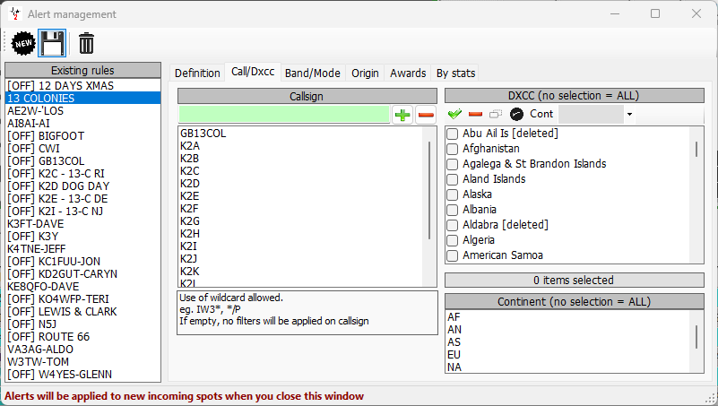

Terry,
Been doing that for 8+ years. Problem becomes with once I work a given station (IE: K2A) I don't need to work them again and the spots keeping appearing. Only way to resolve is to open up Alert Manager and then 'delete' K2A from the callsign list.
Not a big deal in the scheme of things, but I do have to recall to rebuilt the callsign list at the end of the special event for the next year.
It would be nice if there were an edit toggle of on/off for each callsign entry with the +/- to add or delete. Similar to what is used in other panels to enable/disable given option choices.
Or another solution I've used is to build an Alert rule for 'each" callsign and then just turn them on/off when I work the event of 13 Colonies, Route 66, Lewis & Clark, etc..
