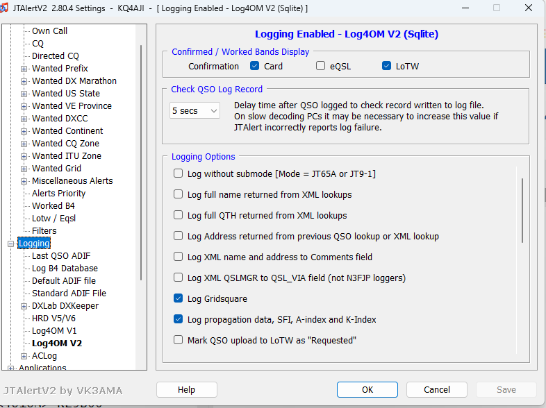

FYI, I finally found where the problem was, JTALERT was sending the REQUESTED flag. It can be corrected by
If using JTAlert, both with WSJT-X and JTDX.
OK, I now see what happened: there are settings associated with the "Logging" header, not just with the sub-headings.
I'd missed that.
"Mark QSO upload to LoTW as 'Requested' " was checked by default. I unchecked it.
Found it elsewhere on the Internet
Also, FYI, the trick to bulk updating in QSO Manager is to check the 'Enable Updates' It's a busy screen so could be overlooked if not used much or ever. I'm sure them manual explains it well, if you know what you're looking for
I'd missed that.
