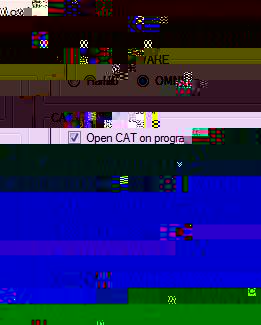

How have you got the cluster settings set - see screen shot below
- Capture.JPG (24.13 KiB) Viewed 5071 times

Thanks Terry, I am using Omnirig and I will check the settings later when I return home.
Bob.
M0BOB.
