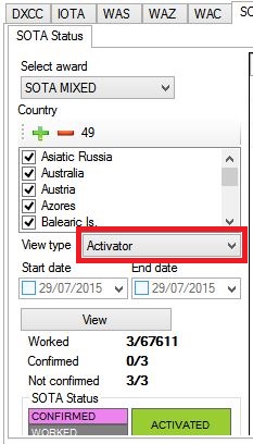

And if you click the green + sign to select all what happens then?
Re: How to export SOTA activator log to upload to SOTA site?
It then checks all countries in list, and shows records in a grid, but only ones that originate from selected countries.
List of countries does not have all countries, just those that are covered by SOTA.

OK now I can understand what you are reportingyt9tp wrote:It then checks all countries in list, and shows records in a grid, but only ones that originate from selected countries.
This is how it should work.......
If you select "Chaser" then only the valid SOTA countries should be available in the country list
When you select "S2S" only the valid SOTA countries should be available in the country list
When you select "Activator" all DXCC countries should be available in the country list - If this is not happening it is still only listing SOTA countries.
I will speak to Lele and see itf its possible to get this fixed for the next release.
Thank you for your patience in discovering this issue

Sorry, maybe i'm missing something.
When you set ACTIVATOR the software will show the LIST OF YOUR ACTIVATED SUMMITS.
By clicking the EXPORT button on the activation you will see all contacts that have MySotaRef set as the current sota reference.
I can see here all callsigns i have set, also a TA4something (turkey is not part of SOTA associations). I have successfully exported them.
If you select ACTIVATOR, the program will show the list of countries that you can MAY HAVE ACTIVATED, the list is NOT the list of countries you have CONTACTED, but the list of countries that have summits that can BE ACTIVATED BY YOU. Obviously you can activate only summits / countries that are listed in SOTA program. If you have activated more than one country, the country list allow you to filter the countries you want to see as activator (it's probably not useful because you probably activate summits on your country only, but...)
I'm still missing something?

I have a feeling that Pedja has not selected 'Activator' in the SOTA status screen.
