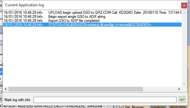

I have tried uploading QSO's to your QRZ account using the API method and everyone fails to upload, regardless of the call sign
However doing a Log4OM export of a QSO and then importing it manually on the QRZ web site works fine, including K5P
As you are the only person reporting this issue also when I do a QRZ API upload from my own logbook it works faultlessly therefore I have to assume there is something wrong with your QRZ account.
Unfortunately QRZ do not return an error report detailing the issue as some other online logbooks do all we receive is the following:
STATUS=FAIL&REASON=missing <eor> in record&EXTENDED=
Which does not tell me much
Is there a mechanism that I can use to monitor external service uploads such as this?
Help - Show real time log
I will study this further but I firmly believe that although your membership is paid and current that something is not enabled on the QRZ logbook database by QRZ which is blocking the API upload

For some reason, it's not seeing the end of record.
Re: K5P contact upload to QRZ logbook
K7PT wrote:For some reason, it's not seeing the end of record.
No its the bit before 'Missing'
