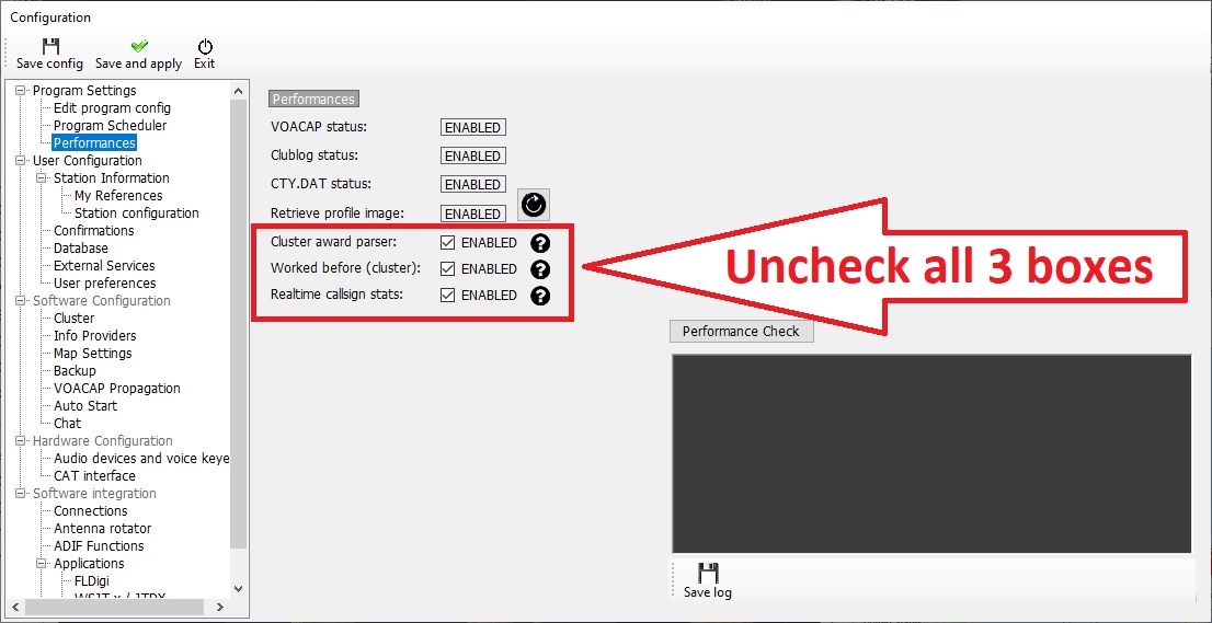

Re: CPU usage after starting Log4OM2
SV5FRI wrote: 27 Feb 2021, 11:47 Dear Terry,
I have send you with email the log files from my Log4OM
Appologies for the delay but I have been very busy.
Regarding your high processor demand
1. I note that Log4OM and probably WSJT are not being 'Run as an administrator' You need to change this for both programs and also Omnirig. - SEE PAGE 13>>> OF OUR USER GUIDE
2. What is the processor demand like if you only run Log4OM (WSJT and ALL OTHER SOFTWARE closed)
3. What cluster servers are you using?
4. Have you tried unchecking the boxes shown below and then clicking Save and apply button?
I will make this change and inform you for results

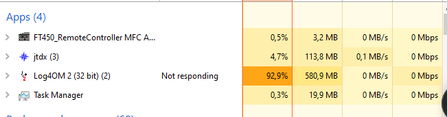

hi
I Would like to inform you that after changes the same problem.
I have attach screenshot from task manager
Please for your advice
