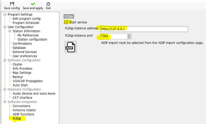

gm Terry
ah may be where ? because morning i check again setup in log4om and i cant see anywhere xml rpc ..only in flidigi i can see
73 Eric
F1SMV

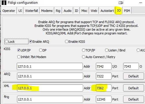

Not sure what version of FLdigi your using but it should be 4.1.08 or later and you need the I/O config tab not rig control

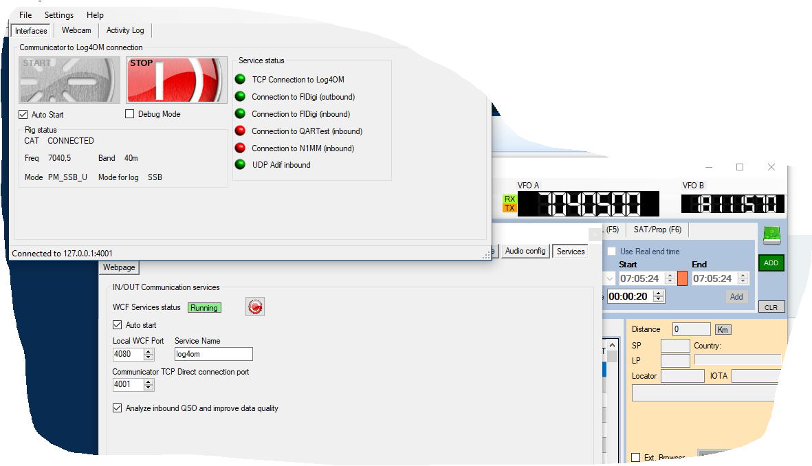

Bonjour Terry
i use fldigi 4.1.09.12 version ...
Mark
do you think i must back on vspe ? ..but i try without more success..
this morning i test in same cfg my "old version" of log4om (version 1), work ! tx is ok
for your info i put my setup , i see tcp port arent the same does i must change in misc\tcpip sessions ?
73 Eric

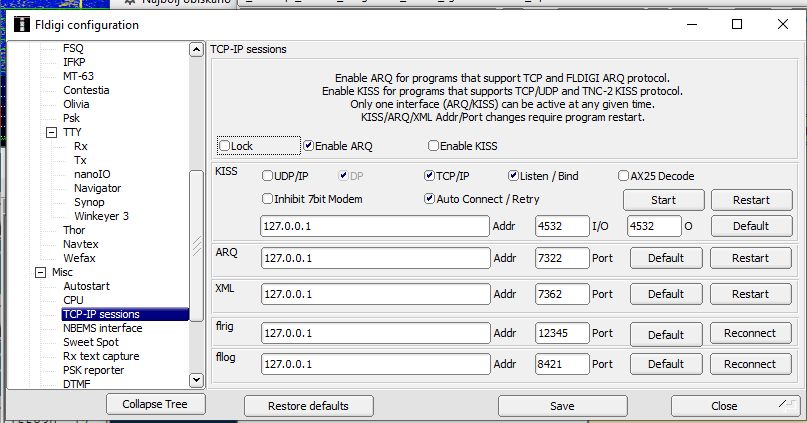

HI Eric
FLdigi 4.1.09 has new look of Configuration window and look on picture where you find TCP-ip session.
It is working for me.
