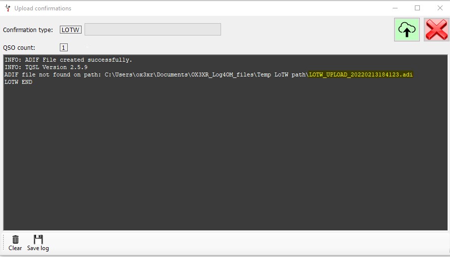

PeterOX3XR wrote: 29 Jan 2022, 12:36 Log4OM V2 ver. 2.19.0.0, 230122.jpgNolan,
I have installed Log4OM V2 rev. 2.19.0.0
There are still problem uploading to LoTW. Apparently it does not create an ADIF file.
It was possible (suddenly) to upload with ver 2.18.0.0 on Jan. 23. However, with 2.19.0.0 there is a problem generting the ADIF file which must contain app. 70 QSO's.
I have attached a screenshot showing the error message.
Brgds
Peter
OX3XR
Did you set a temp folder for LOTW in the Log4OM config, if so what is the full path to the folder

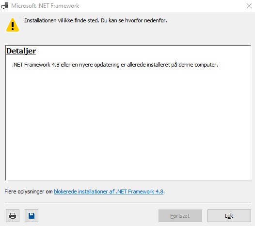

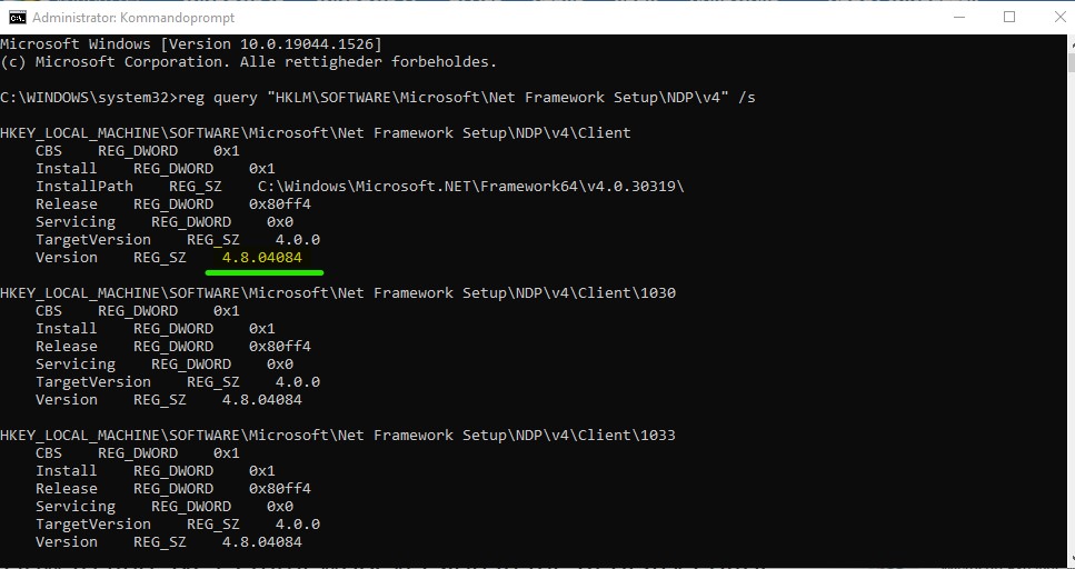

Hello DF5WW,
.NET Framework update report that I have Ver. 4.8 or newer.
I use only manual upload to LoTW. The file reported (see screenshot, yellow marking) is not found in the temp folder.
Log4OM V2 Rev. 2.19.0.0 no LoTW upload.jpg (43.42 KiB) Viewed 2692 times

Hello all,
I have installed Log4OMV2 ver. 2.20.0.0, and I have NET version 4.8.04084 installed. I still have problem with uploading to LoTW.
Log4OMV2 ver. 2.20.0.0 does apparently not save the adif file as previously informed.
What is next step in this troubleshooting?
