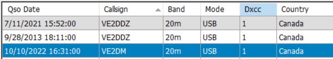

This is the recent grid showing the country and dxcc - canada #1

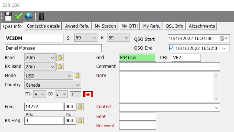

This is the Edit QSO UI showing the same thing.
Except for changing the country, how to you suggest I change the dxcc?
I did this once with no change.
73 - Jim Plahitko - KJ9Z
