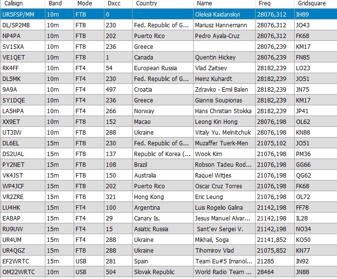

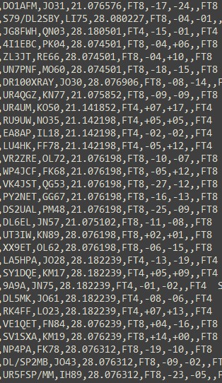

I had the same issue allthough I am a XML subscriber on QRZ.com.
My GRID was also shown as the country GRID and not my real locator, that changed back to normal after doing Nolans settings.
In v 2.25.0.0 it was working without changing anything..
I operate a lot of FT8 and the logged GRID from the WSJT-X ADI file is different now from the stored GRID in Log4OM and because of this it also gets uploaded with the wrong Data to the external sources such as LotW, QRZ.com and eQSL.cc
The first Screenshot shows how the QSOs were saved in Log4OM and the second screenshot is an extract from my WSJTX.log (in the adif file the same GRIDs are saved of course)
How can I correct the GRIDs properly in the Log4OM log?

- Screenshot 2023-01-24 143027.jpg (166.54 KiB) Viewed 816 times
- Screenshot 2023-01-24 142907.jpg (112.69 KiB) Viewed 816 times
