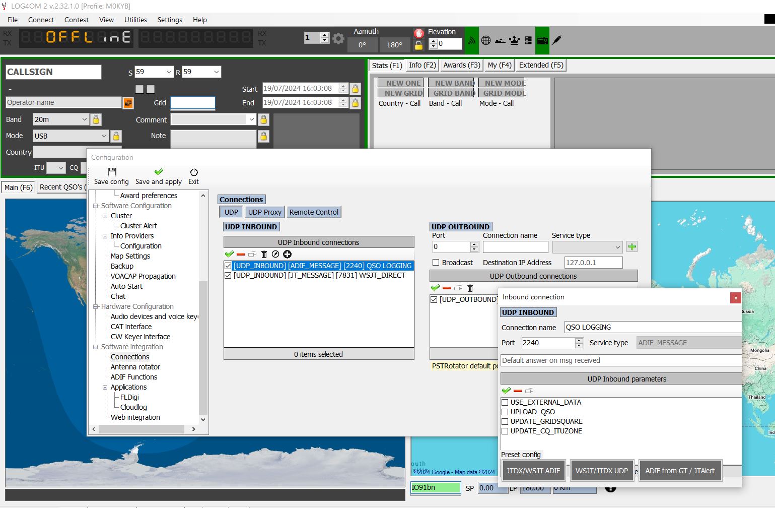

I've just upgraded to version 2.32.1.0 and am trying to save a new UDP Inbound connection. There is no save button in the window bottom right!! So I can't save the new connection, see screenshot. The window can't be resized either ...
Marc
