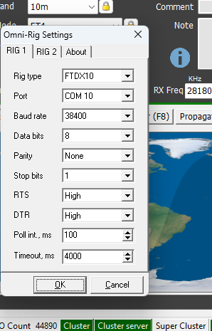

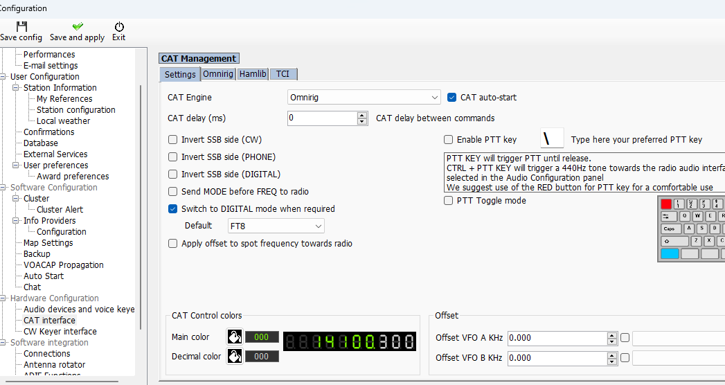

I need exact frequencies and a screen shot of your CAT config in Log4OM ASAP please as we have weeks holiday starting tomorrow
Thanks Terry
Note as attached.
Regards
Gavin
ZL3GAV
Log4OM ZL3GAV CAT.png (43.39 KiB) Viewed 1905 times

Re: Flashing Mode & s/r Signal Report
Gavin,
Take a screen clip of your CAT settings in the Log4OM Configuration page as well.

KI5IO wrote: 20 Aug 2023, 00:31 Gavin,
Hi Nolan,
As attached, no change in toggling the FT8 checkbox off/on.
Gavin
ZL3GAV
ZL3GAV CAT config.png (67.53 KiB) Viewed 1895 times
