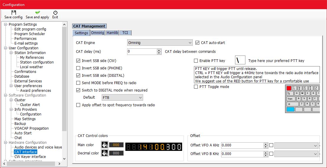

Tnx for the additional input. I just tried similar. Log4OM "only" connected via USB port to my K3 and dialed to FT8 frequency and I did not experience any 'flashing'.
I'm also using Omnirig and i've attached my CAT settings in Log4OM. Dunno if any button tweak in that setup is affecting the FTxx flashing situation or not.
May be "rig" related as well, but not sure as of yet.

Re: Flashing Mode & s/r Signal Report
Hi Nolan,
Tried your settings and still got the flashing.
