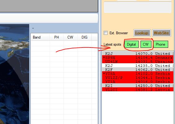

And when the cluster is running, I turn off CW and digital to just see the phone spots. Can that be saved too?

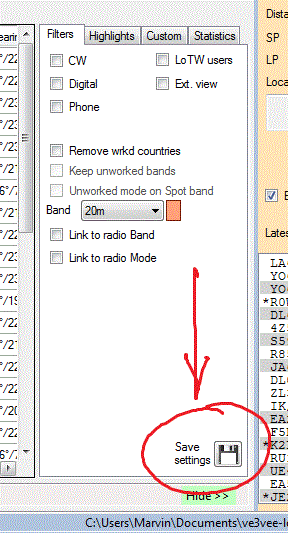

Hi G1YBB,
Yes:
73 Marvin VE3VEE

Yes, but my answer was not in relation to the layout. I was answering your question about the CW/DIGI/PHONE filters:

VE3VEE wrote:Yes, but my answer was not in relation to the layout. I was answering your question about the CW/DIGI/PHONE filters:
Ah I get you now. I never use that F9 screen, I like the map view.
These are the ones I wanted to stick unselected:
