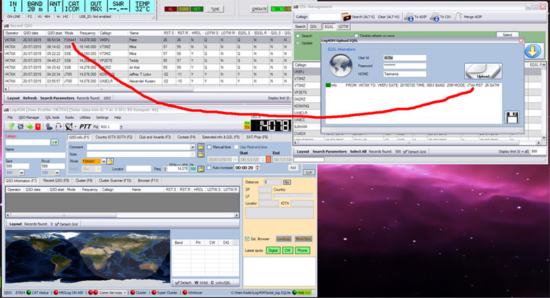

OK, here is some "interesting" info. I just created a log entry for the mode FSK441 and, when I uploaded it, the following screens were displayed. (attached, I hope).. note the change indicated by the red line. I immediately checked the "Show Log" and it saidVK7XX wrote:I haven't had the chance yet Terry. I haven't had a FSK441 contact since I made my original post.G4POP wrote:Did you ever check the Log4om "Show log" as I suggested in my earlier post?
John
"2015-07-20 16:53:47.1836 INFO: EqslManagement: Send log start
2015-07-20 16:53:47.1836 INFO: AdifManagement: Begin EQSL row creation for Call: VK5PJ Date: 20150720 Time: 065304 Band: 20m Mode: FSK441
2015-07-20 16:53:49.1523 INFO: EqslManagement: Send log completed "
I then went to EQSL and sure enough, as per the right hand window in the attached image, it was recorded as a JT44 contact which is what Log4om indicates in that window (but indicated differently in the log)..
are you confused yet, 'cause I am..
John
- modechange.jpg (92.24 KiB) Viewed 5114 times

Further info.... this is an ESQL problem.
I have had a message back from EQSL support staff and they have discovered that even when using other logging programmes, not just Log4om, when directly uploading via the logging software, mode FSK441 is being changed to JT44 however, if contacts are exported as ADIF & then uploaded to EQSL, the mode is not being changed. They are looking in to it and hope to have it fixed soon.
<phew> 73 John VK7XX
