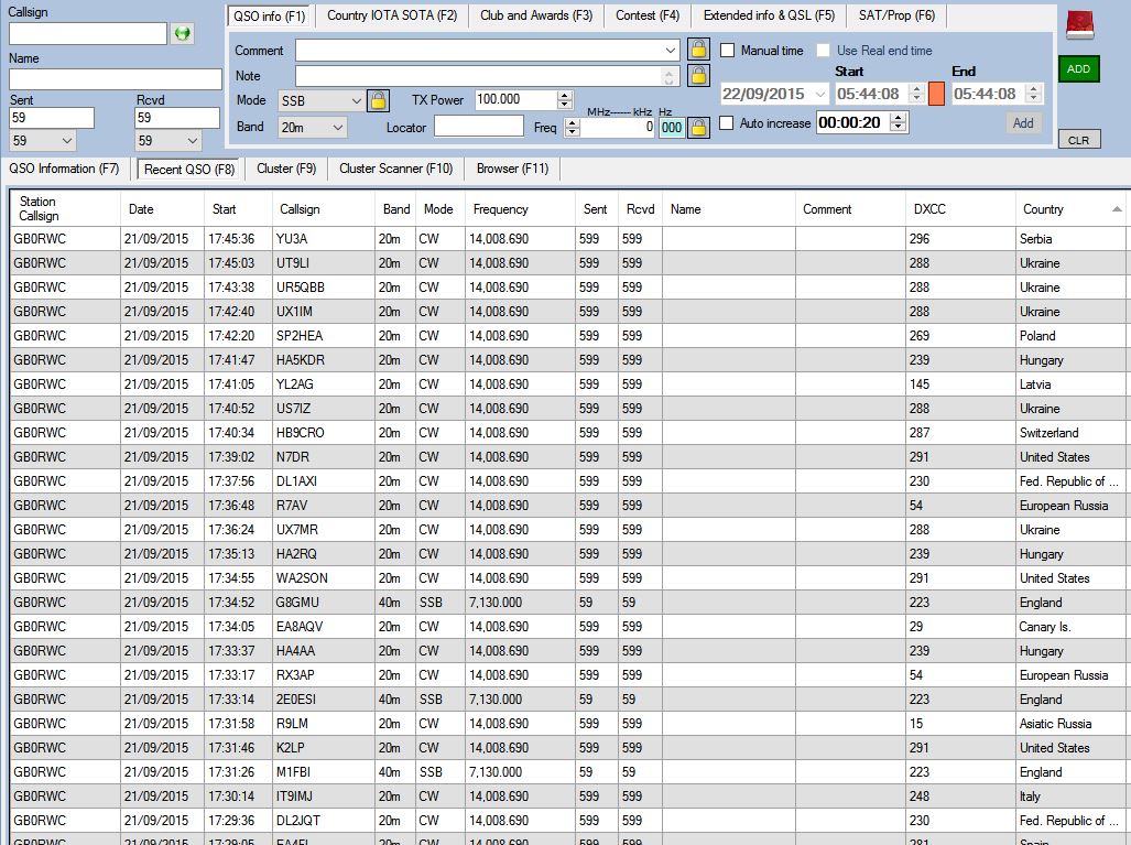

Thank you for sending me the N1MM ADIF file which of course does not contain either the DXCC number nor the country name, I would have expected this to have been rectified in the new N1MM but apparently not!
I imported the ADIF file into an empty Log4OM logbook, having checked the box "Update Countries in ADIF" in our ADIF import window and as you will see from the screenshot below the countries and DXCC were all updated OK
There were however 10 entries that had odd call signs like SW7GRM, UA2 with no suffix letters and DL-SWL/DE1PCE which of course no logging software is going to recognise also a 2Ezero call that was entered as a 2EO :D but these few you can manually edit easily
